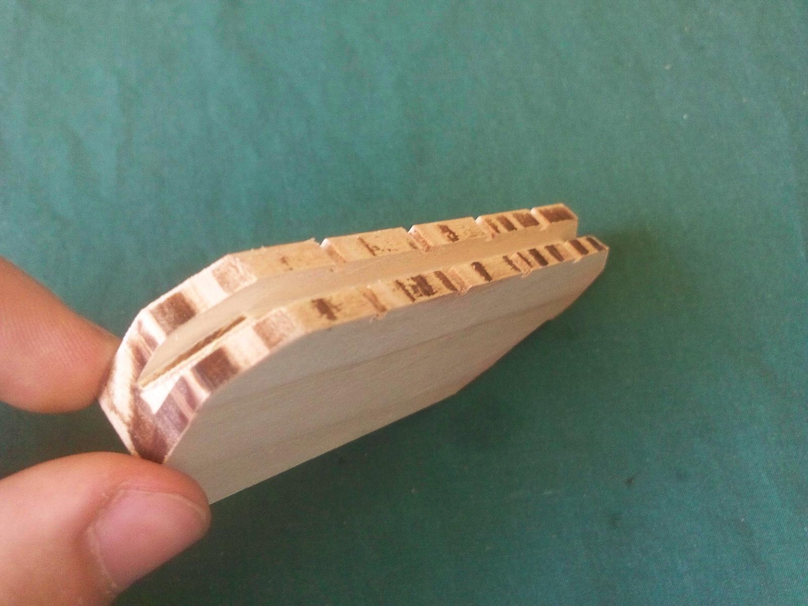

GuruD Posted March 26, 2010 Author Share Posted March 26, 2010 So here is the next update on the predator. I redid the sides so that it would be a little smoother, and I am much happier. Next I ran the bottom of the sides down along a table saw to cut a grove for the wheels for the track. Here Are the wheels ready to be inserted. I cut them from a half inch wooden dowel. Here they are glued into place. The next step is to make the tracks out of an extra large zip tie. The one side has the nice ridges that will give a track like appearance. So I will be taking a heat gun to them a little bit at a time to bend them arround the wheels. I will hopefully have pictures for that up tonight or tomorrow. Link to comment Share on other sites More sharing options...

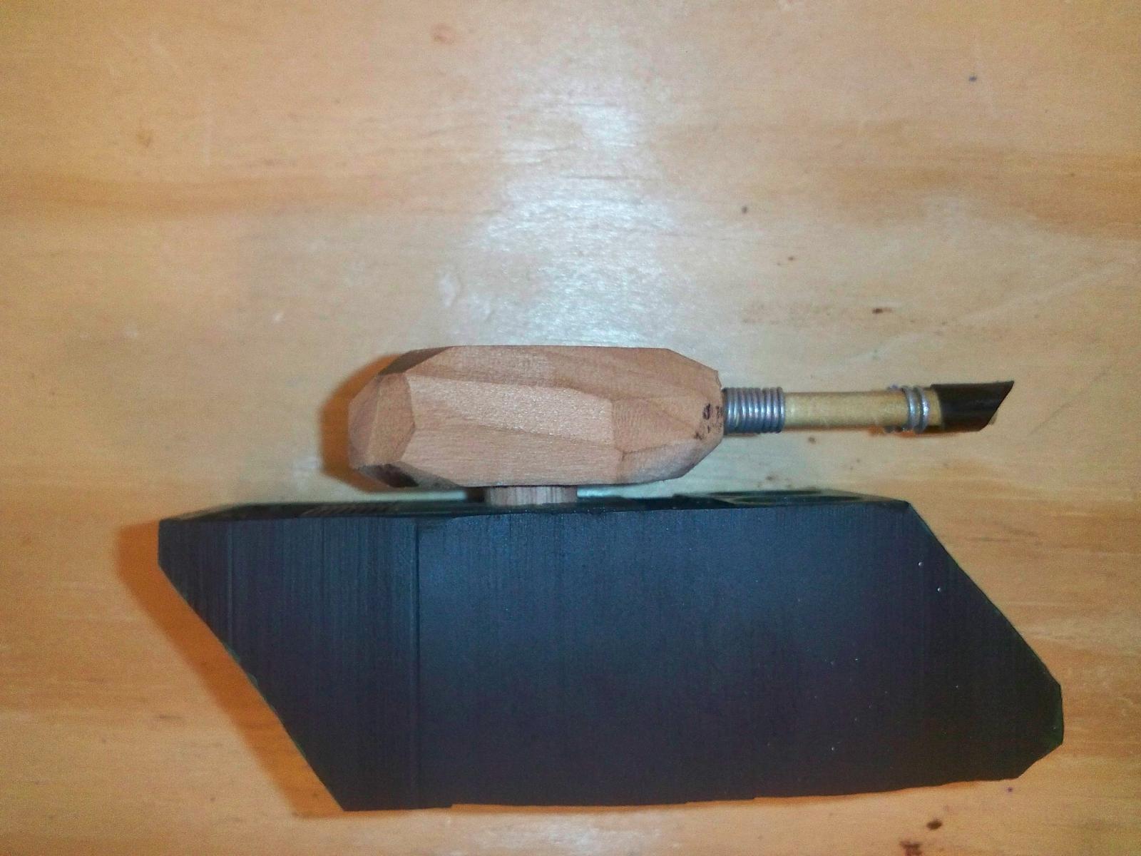

GuruD Posted March 30, 2010 Author Share Posted March 30, 2010 Here is the start of the tread. I am using an extra large zip tie and bending it with a heat gun. Here it is shaped after about 10-20 minutes of using the heat gun. Here it is attached. Here is the turret ready to be mounted. I drilled a hole in both the turret and the hull, then glued a .5" peg into the turret. So it still can swivel. Here is a side shot after it was mounted. Here is the front of the turret showing the now drilled out Lascannons. Here are the exhaust pieces for the sides. I cut a .5" dowel in half with the bandsaw and then drilled a hole into the top for a .125" dowel. Things are coming along quite nicely. Link to comment Share on other sites More sharing options...
