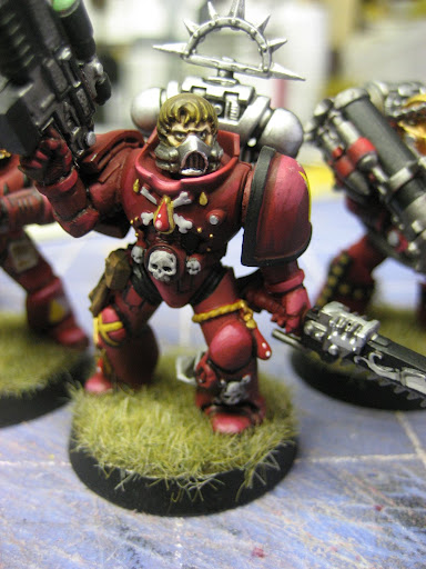

Redfinger Posted February 16, 2011 Share Posted February 16, 2011 I have been using vallejo paints now for about 10 years, and I absolutely love them, they have great color ranges, easy to use, I can use them in my airbrush, the hand brush nicely and blend wonderfully. To answer your specific questions about colors, I use the following; Flat Red Black Red Red Sky Grey Foundation White these are the colors I use for the basic foundation of my marines. 1.First off the mini gets airbrushed w/ black red that has been thinned down w/ Windex, and that has had a further drop or two of a 50/50 mix of future and water, this serves to harden the paint a bit. 2. The next thing I do is take the red and touch up any spots that the spray may have not reached. 3. 3rd is a highlight airbrush coat of flat red, this is sprayed downward while holding the mini in such a way that the flat red spray is only sprayed from the top down, cathcing only the edges of the mini 4.Next comes the flat red that I use as the initial foundation of my highlights, this is brushed on the edges, then I then start mixing the sky grey and flat red to build the highlights up with the final highlight being applied as a mix of foundation white and flat red Here is a pic of the finished result; And a link to a series of fictures that describes the above proceedure; https://picasaweb.google.com/RedModeling/AirbrushMini# Have fun and enjoy working with those paints! Ashton Link to comment https://bolterandchainsword.com/topic/222564-quick-painting-query/#findComment-2661292 Share on other sites More sharing options...
goldenwonder Posted February 17, 2011 Author Share Posted February 17, 2011 Thank you all for the brilliant feedback. I think I will definitely experiment with Vallejo paints - thankfully, I have a number of metal Death Co models whech can be used as test models and stripped later. Highborn Mergula that colour chart is fantastic, a real time and money saver. Redfinger - thank you for sharing your painting method. The end result is fantastic (especially the face in the picture). I do have one quick question though - you make reference to use of an airbrush. I've been thinking about an airbrush for a while. Would one of the GW spray guns achieve the same effect or is it more for basecoating? When it comes to airbrushing I have a lot of interest but very little knowledge. Again thank you all for the help, it is much appreciated. Link to comment https://bolterandchainsword.com/topic/222564-quick-painting-query/#findComment-2661993 Share on other sites More sharing options...
