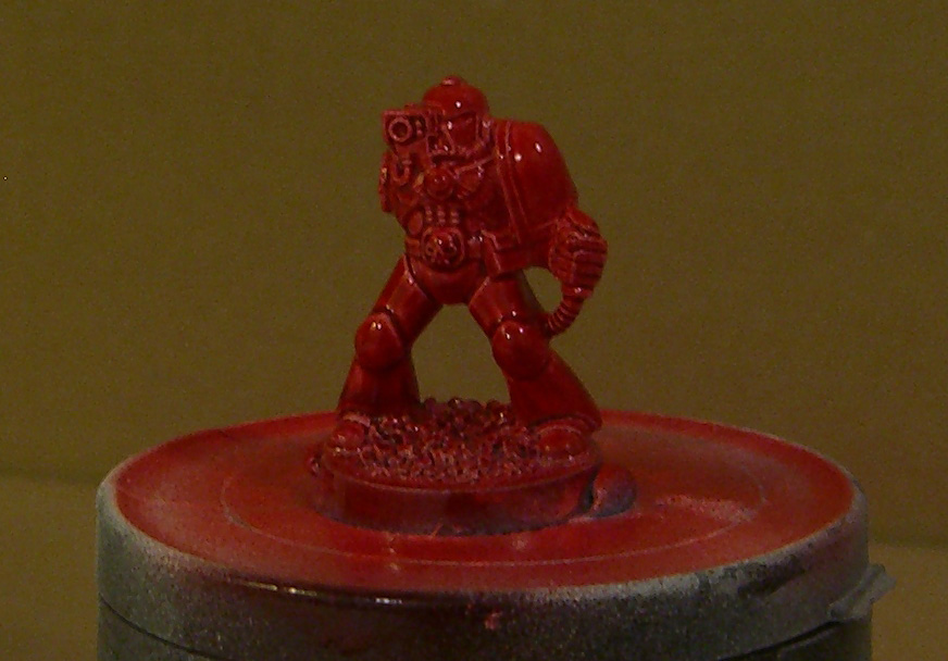

Wendigo Posted June 19, 2011 Author Share Posted June 19, 2011 Thanks, Ignatia Mortis. Well, bad news: I oversprayed the second basecoat layer. He's still drying, but I might have obscured detail. When he dries, I'll post a pic for you all to judge whether he's headed for a brake fluid bath. *Edit 19 June 2011: In retrospect, my big mistake was not thinning the second basecoat layer like I had the first layer. If I had thinned the second basecaoat layer, it might have looked a lot better. Wendigo Link to comment Share on other sites More sharing options...
Wendigo Posted June 19, 2011 Author Share Posted June 19, 2011 Oversprayed and wrecked? Should I strip the paint and start again? W. Link to comment Share on other sites More sharing options...

Brother-Chaplain Kage Posted June 19, 2011 Share Posted June 19, 2011 The primer looks good. The basecoat does not. That's way too thin and airbrushed paint shouldn't pool on the figure like that, and since it's so translucent, more layers may not cover it up. *edit* D'oh, I had to go afk and you posted again before I did. Yeah, I'd say you should probably strip it down and start again. Link to comment Share on other sites More sharing options...

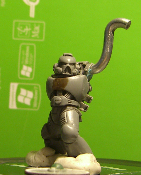

Wendigo Posted June 19, 2011 Author Share Posted June 19, 2011 Thanks for the feedback, Brother Chaplain Kage. I agree with you 100%. It's back to the drawing board for the basecoat. And back into the brake fluid bath for the little Devastator... Here are a few more pics of the Fenris Militia Thane: *Update: broke the curved heat pipe off the backpack. Need to pass length of wire through wide hole drilled horizontally and from side to side through the top of backpack, i.e. cross-wise under the "heat grill" at the top of the backpack Link to comment Share on other sites More sharing options...

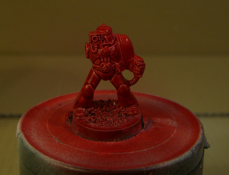

Wendigo Posted June 19, 2011 Author Share Posted June 19, 2011 Thanks, Rod Hull. I appreciate the encouragement. I have been going through YouTube, but I'll have another look. Thanks for the tip. I can tell already -- I'm gonna love using an airbrush once I work out a few beginner problems. Here is the final cured result of the over-heavy spray of Liquitex Alazarin Crimson over a Vallejo white primer. *Mistakes: 1) PSI too high (was 30-40; should have been 15-20) 2) did not thin second basecoat layer enough -- Liquitex Soft Body paints need heavy dilution 3) Primer layer too thick? 4) May have been spraying too close, or focusing on single areas too much and over-spraying Link to comment Share on other sites More sharing options...
