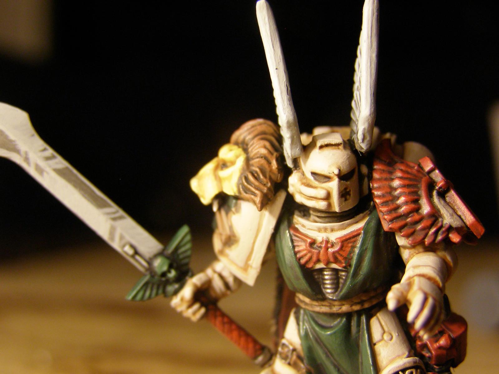

company veteran Posted December 21, 2011 Share Posted December 21, 2011 i wanted to share my recipe for my deathwing as ifeel it is a simple and effective paint job. lemme know if it helps at all STEP 1: basecoat your model with denheb stone. a few watered down coats over a black undercoat gives a smooth finish STEP 2: wash heavily with gryphonne sepia, leave to dry, and if need be wash again STEP 3: reapply denheb stone to all areas leaving recesses dark STEP 4: mix 1 part skull white with 2 parts denheb stone and apply to ridges and raised areas STEP 5: mix an equal amount of skull white to denheb stone and repeat ridges and raised areas in a thinner line this can be used effectively for stonework too: I SINCERELY HOPE THIS HELPS SOMEONE :P Link to comment https://bolterandchainsword.com/topic/243835-deathwingbone-armour/ Share on other sites More sharing options...

Vanek Posted March 4, 2012 Share Posted March 4, 2012 Nice bone color! I'm definitely going to use this for my deathwing. What model is that? Link to comment https://bolterandchainsword.com/topic/243835-deathwingbone-armour/#findComment-3006915 Share on other sites More sharing options...
MasterAzrael Posted July 14, 2012 Share Posted July 14, 2012 What model is that? This is Lion El'Jonson my dear friend. You can read more about him in the Dark Angel Codex. Link to comment https://bolterandchainsword.com/topic/243835-deathwingbone-armour/#findComment-3121531 Share on other sites More sharing options...
hmk17 Posted July 17, 2012 Share Posted July 17, 2012 I think he was more looking to see if it was a purchasable model. Its a kit bash. GK PA legs, DA Torso, BT Helmet (wing Wings added), Sanguinary Guard left shoulder... its a very nice conversion. Link to comment https://bolterandchainsword.com/topic/243835-deathwingbone-armour/#findComment-3124474 Share on other sites More sharing options...
ultramarine373 Posted July 18, 2012 Share Posted July 18, 2012 okay i'm def gonna use this for my deathwing allies and on a side note that model looks amazing awesome kitbash but if its meant to be the Lion you should use terimantor legs to make him bigger than every one else, just a friendly suggestion. Link to comment https://bolterandchainsword.com/topic/243835-deathwingbone-armour/#findComment-3125200 Share on other sites More sharing options...

Burn_the_Heretic Posted October 12, 2012 Share Posted October 12, 2012 Skull White = White Scar Gryphon Sepia = (apparently) Seraphim Sepia Deneb Stone = (apparently) Rakarth Flesh. Bear in mind this is what the GW Conversion Chart says. I'm going to try these on a test miniature. Link to comment https://bolterandchainsword.com/topic/243835-deathwingbone-armour/#findComment-3205995 Share on other sites More sharing options...
