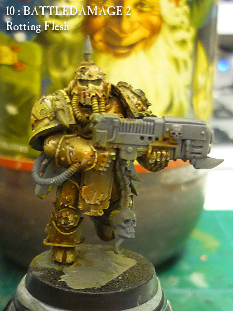

kapturowski Posted May 6, 2012 Share Posted May 6, 2012 I'd go for a brown/black mix of paint for the battle damage, I personally think it looks better than the metallic. Here's how I paint battle damage: I think you can skip black lining your battle damage and just highlight the bottom part of it. Link to comment https://bolterandchainsword.com/topic/251780-weathering-red-pa/#findComment-3054971 Share on other sites More sharing options...
