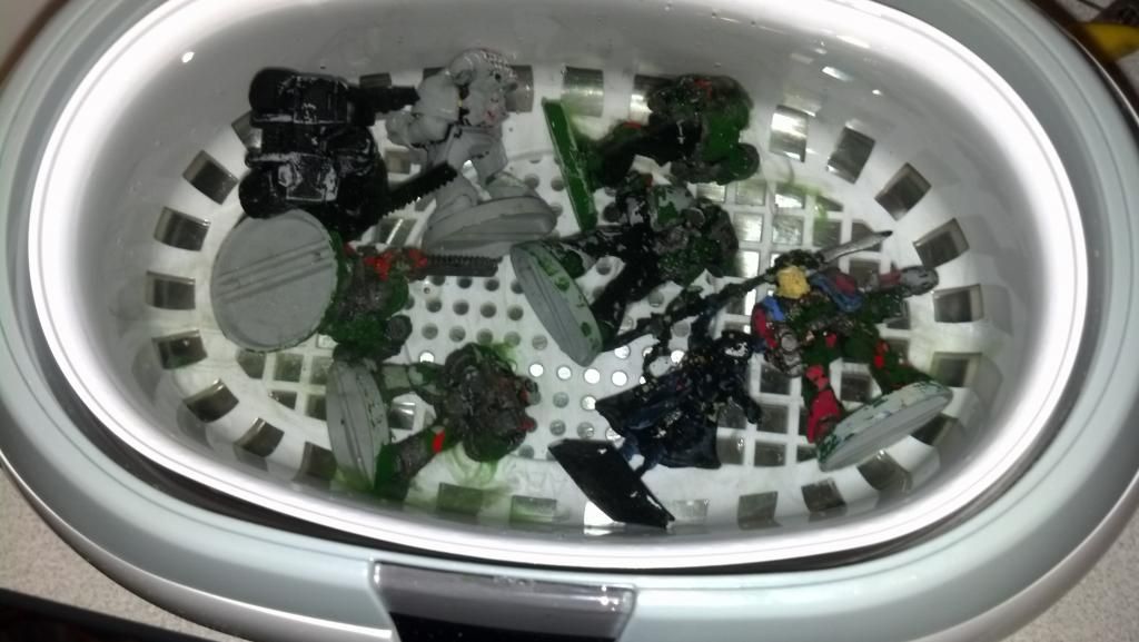

twopounder Posted December 28, 2013 Share Posted December 28, 2013 I'm making a different thread for this to build up a bit on my recent experience using an ultrasonic cleaner for paint stripping. I didn't want to derail the other thread. I just purchased a Chicago Electric cleaner from Harbor Freight today. It holds 600ml (about a pint) of fluid and comes with a little tray for the cleaning items. http://img.photobucket.com/albums/v396/GunMonkey/Space%20Marines/IMG_20131228_091750_804_zps9beac272.jpg The good: It's cheap, at only $33 (20 quid). The Bad: It has a pre-programmed 3 minute cycle and heats up while plugged in, even when not in use. I took a selection of models that needed to be stripped down, including 1 pewter model with basing material,. several plastic models from 2nd edition with very thick paint jobs, one assault marine that was almost nothing but primer, and a marine I had previously stripped using 92% Isopropyl Alcohol and a toothbrush. http://img.photobucket.com/albums/v396/GunMonkey/Space%20Marines/IMG_20131228_070525_728_zps3ec25acf.jpg http://img.photobucket.com/albums/v396/GunMonkey/Space%20Marines/IMG_20131228_070512_768_zpseefc6959.jpg The second ed models were the first I ever painted and I did so over the top of an existing paint job (they were originally blood angels). The first solvent I tried was simple green. I tried running the cleaning cycles right away. After about 5 rounds (15 minutes) not much was happening. I let them soak for an additional 15 minutes and tried again for another 10 cleaning cycles before scrubbing them off with a brush. The results were not impressive: http://img.photobucket.com/albums/v396/GunMonkey/Space%20Marines/IMG_20131228_101745_902_zpsd2fded5c.jpg http://img.photobucket.com/albums/v396/GunMonkey/Space%20Marines/IMG_20131228_101756_125_zpsdf724187.jpg I had to scrub pretty hard to clean off those patches. Next up, I put in a 70% Isopropyl Alcohol solution DISCLAIMER: Isopropyl Alcohol is extremely toxic and highly flammable! Don't use it unless you know what you're doing! I started by soaking the models for about 30 minutes, then ran through about 5 cleaning cycles for a total of 45 minutes in the solution. I could see the paint start to come off the models during the first cycle: http://img.photobucket.com/albums/v396/GunMonkey/Space%20Marines/IMG_20131228_111107_351_zps786ba6d5.jpg Sadly, despite the 5 cycles, not much of an impact was made, though it was better than the simple green: http://img.photobucket.com/albums/v396/GunMonkey/Space%20Marines/IMG_20131228_114639_033_zps7abd14d9.jpg http://img.photobucket.com/albums/v396/GunMonkey/Space%20Marines/IMG_20131228_114631_409_zps5b18031e.jpg More paint came off overall, but I've had more luck soaking them for a couple of hours and attacking with a toothbrush. The basing material and PVC glue did come off in the cleaner and required no scrubbing at all, which is nice. That in itself might be worth your time depending on how many fully based models you intend to strip. Some things to note if you wish to take this route: The cleaner favors whatever side is facing the bottom (where the bubbles originate from). If you can find a way to hang the model so that it is upside down in the tank, it will probably work a little better. You don't want a lot of models in the tank at once. The models at the bottom will absorb all of the cleaning power. It's still a good idea to let the models soak before running cleaning cycles. I'd invest in a higher price and larger model with a removable solution container. Cleaning these out is a pain. Try to get a cleaner that can run for at least 30 minutes at a time. Overall, there is some potential here. I'm not sure if my cleaner is just cheap junk and doesn't clean well, or if you just shouldn't expect miracles. Maybe some other people will post their findings and reviews as well for a better survey of cleaners. Link to comment https://bolterandchainsword.com/topic/285016-ultrasonic-cleaner-review/ Share on other sites More sharing options...

twopounder Posted January 2, 2014 Author Share Posted January 2, 2014 Alright, I went down to the drug store and picked up a couple bottles of 91% Isopropyl Alcohol for further testing. I normally use this to hand scrub the models (soak for around an hour then scrub). This yields about 70% removal of paint. With the ultrasonic cleaner, it was more around 90 - 95% http://img.photobucket.com/albums/v396/GunMonkey/IMG_20140101_161806_247_zpse321cf24.jpg It still has trouble with primer, and some light scrubbing is necessary, but it's much more efficient at overall removal of material. Link to comment https://bolterandchainsword.com/topic/285016-ultrasonic-cleaner-review/#findComment-3558606 Share on other sites More sharing options...
