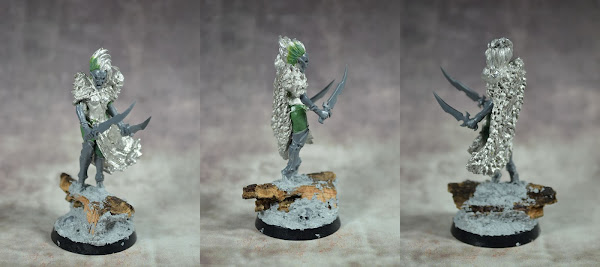

leoparden Posted May 19, 2014 Share Posted May 19, 2014 I prefer to have my miniatures interact with the base/basing. Therefore I make each base separately for each miniature as I build the miniature. In truth I make a bunch of bases and then figure out which pair of legs (or modified pair of legs) goes on which base as I build the rest of the miniature to get interesting poses. Since I use a lot of cork bark in my basing I always pin my miniatures to the base for added strength. Usually I leave the miniature on its base through the entire painting process. My basing is painted mostly with pigment mixes and therefore I like it when I get some on their feet since dust would get all over the place anyway "when in war". Examples: Link to comment https://bolterandchainsword.com/topic/291164-base-with-or-without-the-model-on/#findComment-3693068 Share on other sites More sharing options...
