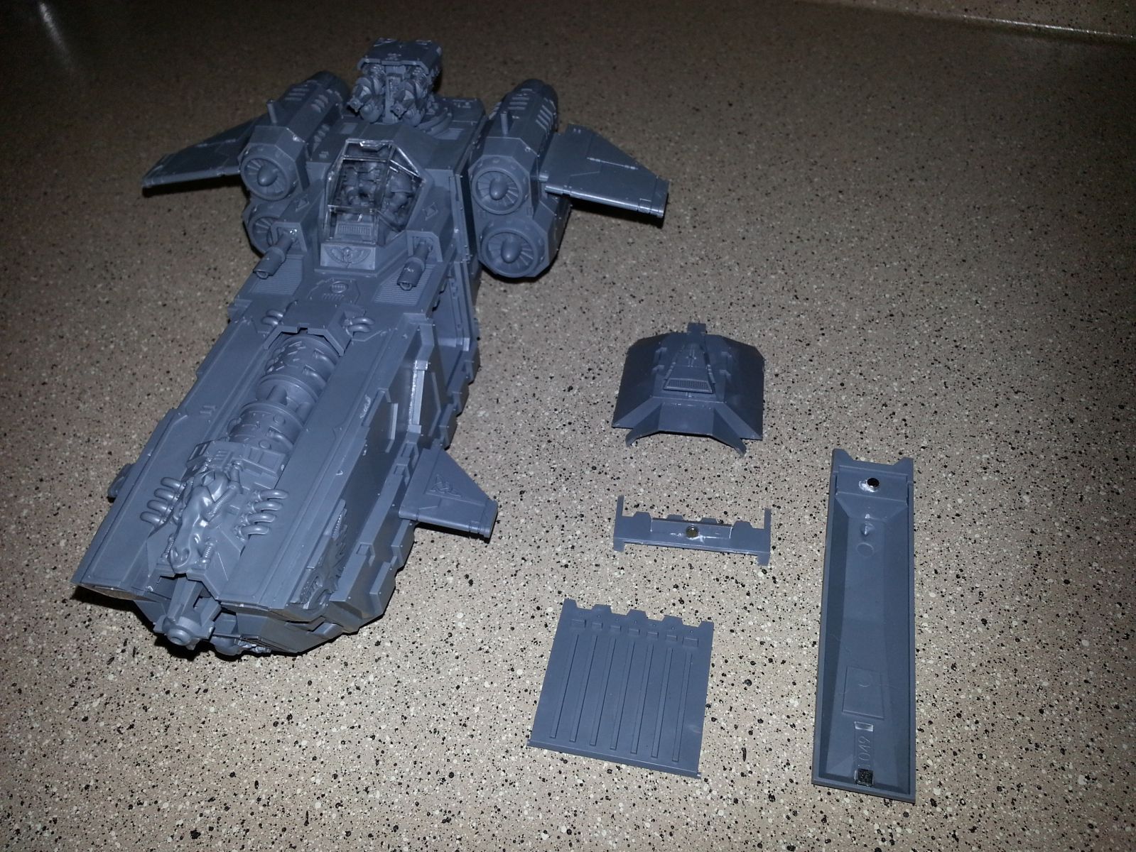

Wulfebane Posted August 3, 2014 Share Posted August 3, 2014 So with most of GW's newer kits, you have options.. this unit, or that unit? Why not both? Here's how to magnetize the Storm Wolf-Claw. And below are the finished products (paint still WIP; will update when done). Storm Wolf Storm Claw Very happy to say that this chassis is fantastic, and indeed able to be magnetized. I wanted to keep it simple, so didn't pull out the plasticard or drills or anything. I decided I would never not run these without the lascannons, so I didn't bother magnetizing those options. The sponsons are a simple thing, so I didn't show them magnetized (but indeed they are!). The transport door on the front I just trimmed the pegs slightly so I could slide it on and off; no magnet needed. The back door is flippable and doesn't need magnets or glue, the fin will just hide inside the hull when in gunship mode. Below is the positions for the magnets I was able to make work. Enjoy. Link to comment https://bolterandchainsword.com/topic/294631-wulfebanes-tutorial-on-magnetizing-the-stormwolfstormfang/ Share on other sites More sharing options...
Wulfebane Posted August 4, 2014 Author Share Posted August 4, 2014 The crossbar is provided by the kit. It's easily inserted and removed from the hull without needing glue or magnets. I glued a bit of sprue on the backside for the magnet I used to have a horizontal angle to rest on. The top piece has two magnets, front and back. The back magnet will be attracted to the one in the following image. Hope this helps. Link to comment https://bolterandchainsword.com/topic/294631-wulfebanes-tutorial-on-magnetizing-the-stormwolfstormfang/#findComment-3765108 Share on other sites More sharing options...

Glasswalker Posted August 22, 2014 Share Posted August 22, 2014 Great post thanks! I used it to magnatize mine. One thing though, with the stand inserted it hits the rear fin if the back if the rear panel is faced inwards. I just glued mine with the fin pointing outwards and figure it could still lower as a ramp if needed. What was your solution to this issue? Link to comment https://bolterandchainsword.com/topic/294631-wulfebanes-tutorial-on-magnetizing-the-stormwolfstormfang/#findComment-3785934 Share on other sites More sharing options...
skeletoro Posted August 22, 2014 Share Posted August 22, 2014 I just ran into the same problem with my two storm grrrrs and am considering just taking a notch out of both flight stands. Link to comment https://bolterandchainsword.com/topic/294631-wulfebanes-tutorial-on-magnetizing-the-stormwolfstormfang/#findComment-3785936 Share on other sites More sharing options...
Wulfebane Posted August 22, 2014 Author Share Posted August 22, 2014 I just ran into the same problem with my two storm grrrrs and am considering just taking a notch out of both flight stands. Oh, sorry.. yeah, this is what I did. Link to comment https://bolterandchainsword.com/topic/294631-wulfebanes-tutorial-on-magnetizing-the-stormwolfstormfang/#findComment-3786019 Share on other sites More sharing options...

Baulder Posted August 23, 2014 Share Posted August 23, 2014 Sorted, worked a treat. Thanks for the guide. Only made one slight deviation, rather than magnetising the skull section of the main cannon it is possible to just glue this to the cannon. This leaves you with a gap so you can slide the cannon on to the side support bars. Link to comment https://bolterandchainsword.com/topic/294631-wulfebanes-tutorial-on-magnetizing-the-stormwolfstormfang/#findComment-3787881 Share on other sites More sharing options...
Wulfebane Posted August 23, 2014 Author Share Posted August 23, 2014 Sorted, worked a treat. Thanks for the guide. Only made one slight deviation, rather than magnetising the skull section of the main cannon it is possible to just glue this to the cannon. This leaves you with a gap so you can slide the cannon on to the side support bars. Agreed. I opted not to do this for fear of scraping the paint. Link to comment https://bolterandchainsword.com/topic/294631-wulfebanes-tutorial-on-magnetizing-the-stormwolfstormfang/#findComment-3787966 Share on other sites More sharing options...

Donnelly Posted September 26, 2014 Share Posted September 26, 2014 Hi was just wondering what was the size of the magnets used thanks. Link to comment https://bolterandchainsword.com/topic/294631-wulfebanes-tutorial-on-magnetizing-the-stormwolfstormfang/#findComment-3818562 Share on other sites More sharing options...
Wulfebane Posted September 27, 2014 Author Share Posted September 27, 2014 Hi was just wondering what was the size of the magnets used thanks. If I remember correctly, they're 1/8" x 1/16" Link to comment https://bolterandchainsword.com/topic/294631-wulfebanes-tutorial-on-magnetizing-the-stormwolfstormfang/#findComment-3819438 Share on other sites More sharing options...
