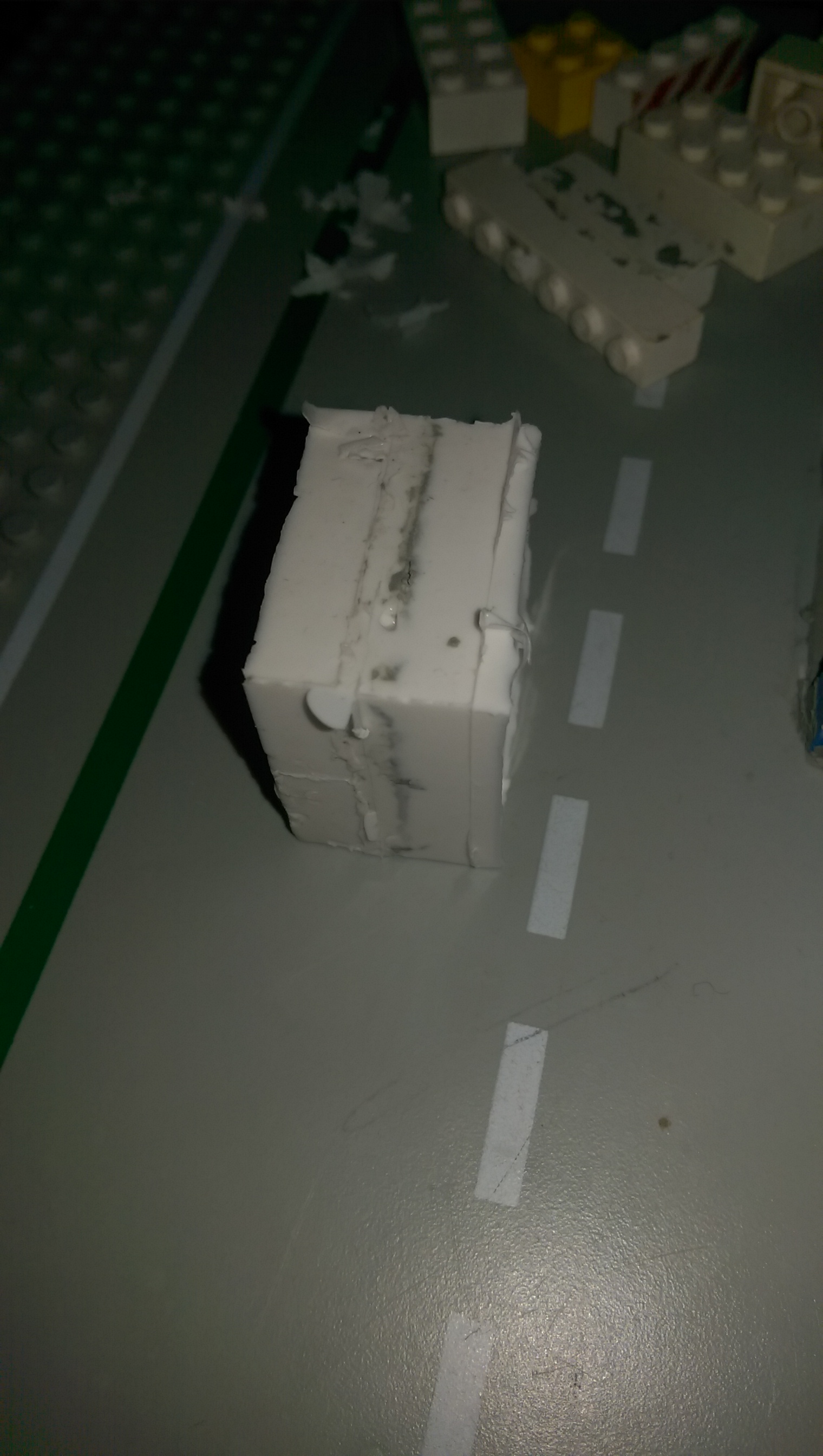

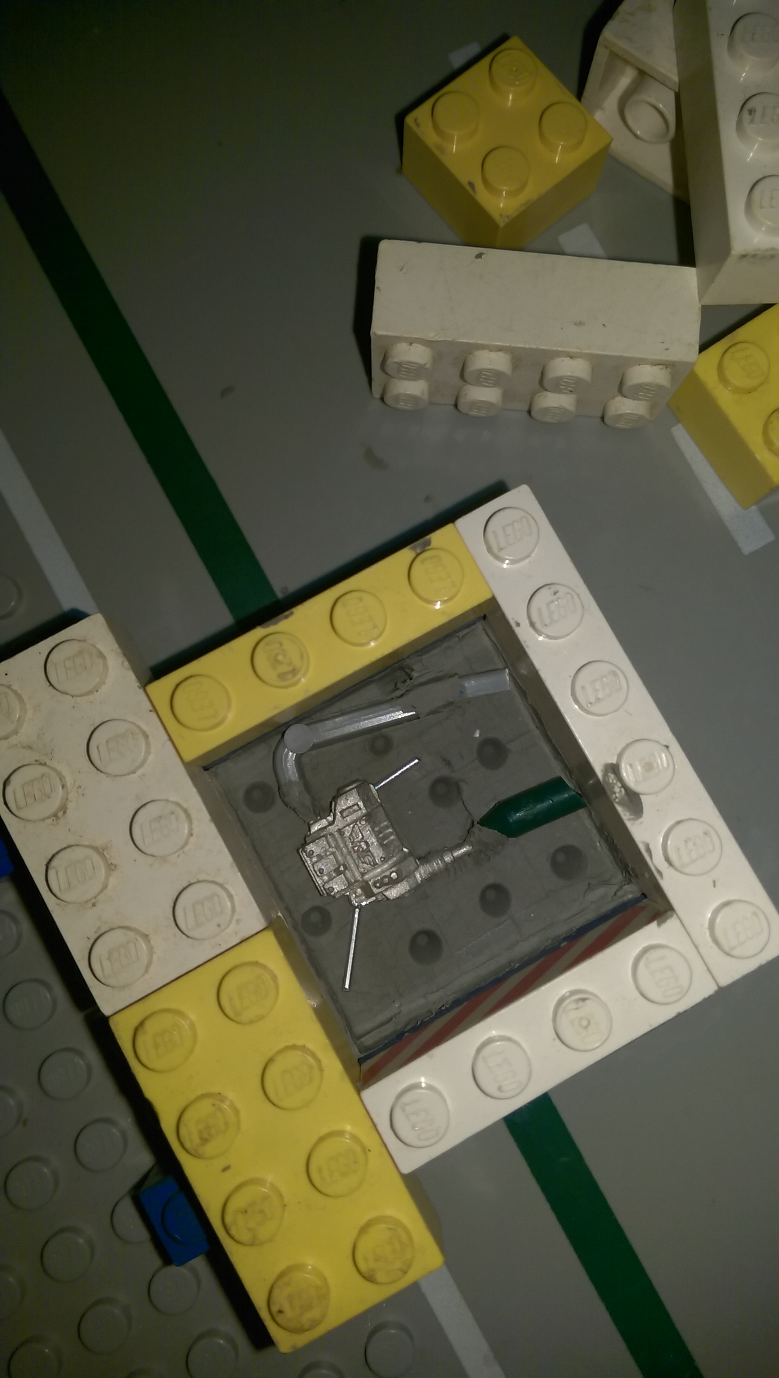

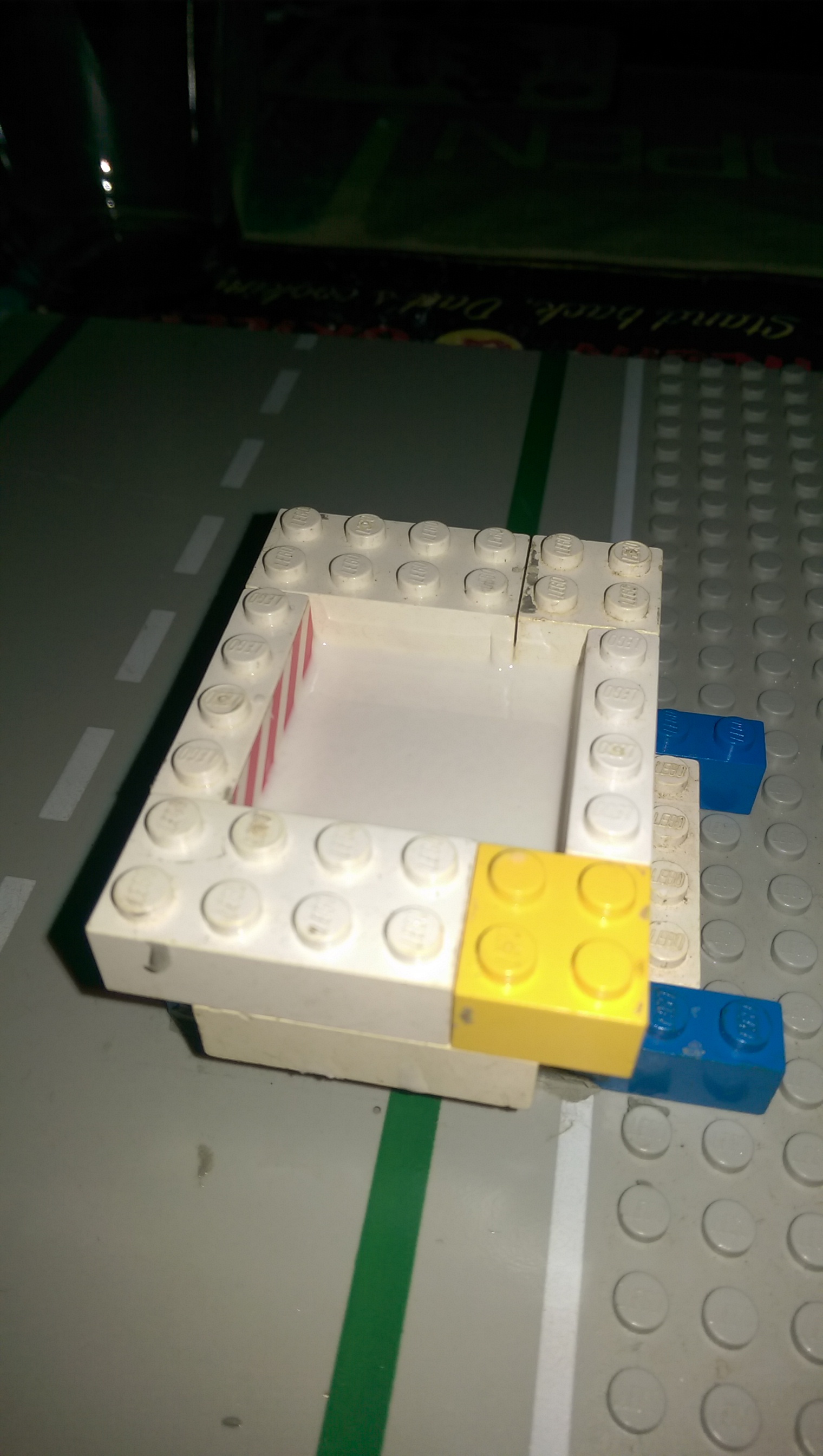

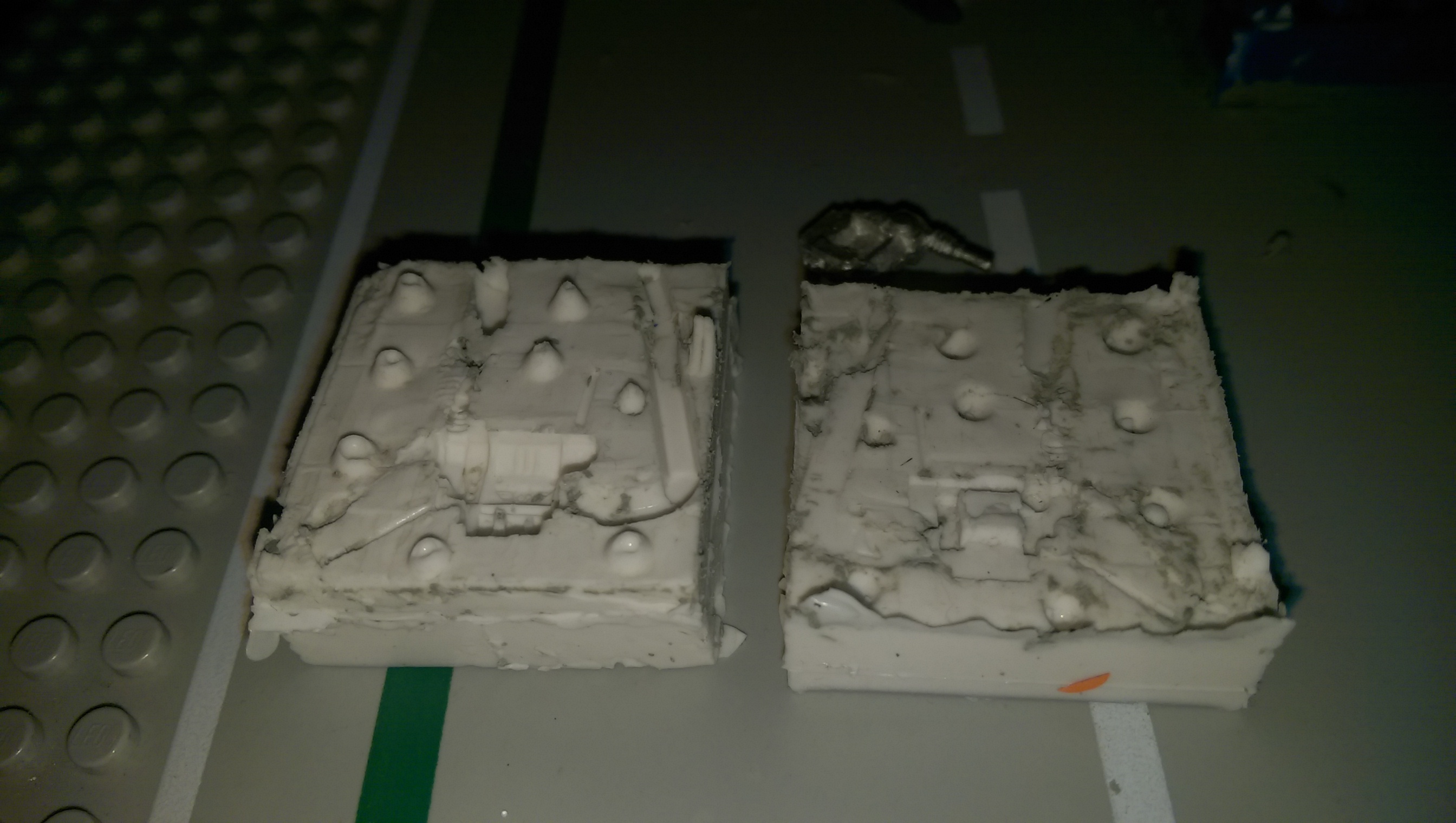

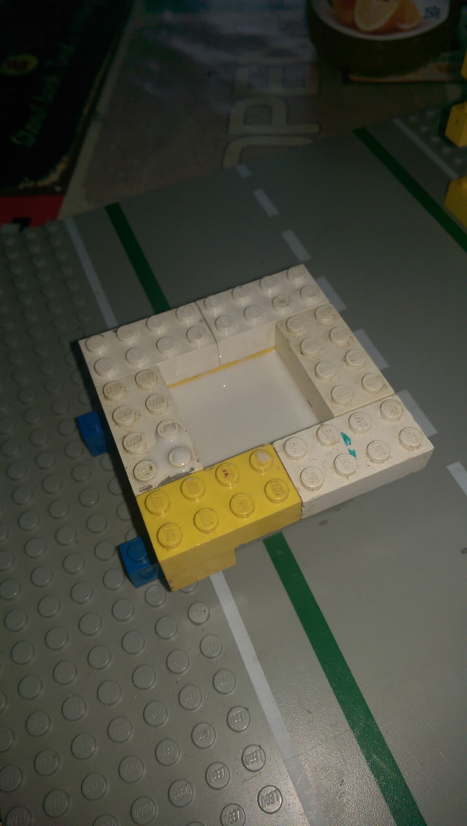

KRG-23 Posted June 2, 2015 Author Share Posted June 2, 2015 Here are the pics of the test. At least, half of them, I need to do the other side of the mold. But it will have to wait, it's Mad Max time at the closest multiplex. Noone suspect the power of LEGOS !! Prep for the test : http://www.krg-23.com/jeux/gw/images/bc/ETL4/th_IMAG0036.jpg The pour : http://www.krg-23.com/jeux/gw/images/bc/ETL4/th_IMAG0037.jpg Unmolding : http://www.krg-23.com/jeux/gw/images/bc/ETL4/th_IMAG0039.jpgI used sculping clay (plastline) as a base for the first half of the mold. Results : http://www.krg-23.com/jeux/gw/images/bc/ETL4/th_IMAG0040.jpg Conclusion : The results are rather meh. The backpack was not positioned horizontaly enough, therefore some silicon spilled under the antenna. I'll have to be carefull once all done. However the 'air escaping conducts' are rather good, I am happy with them. All in all, it's 60% satisfactory. Next time, I'll post up pictures of the finished mold. Link to comment https://bolterandchainsword.com/topic/308391-etl-iv-inquisitor-obeyron-sax-retinue/#findComment-4068680 Share on other sites More sharing options...

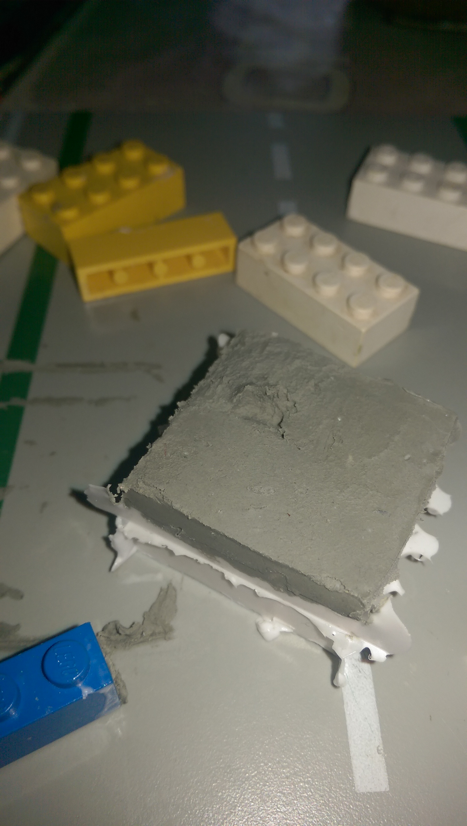

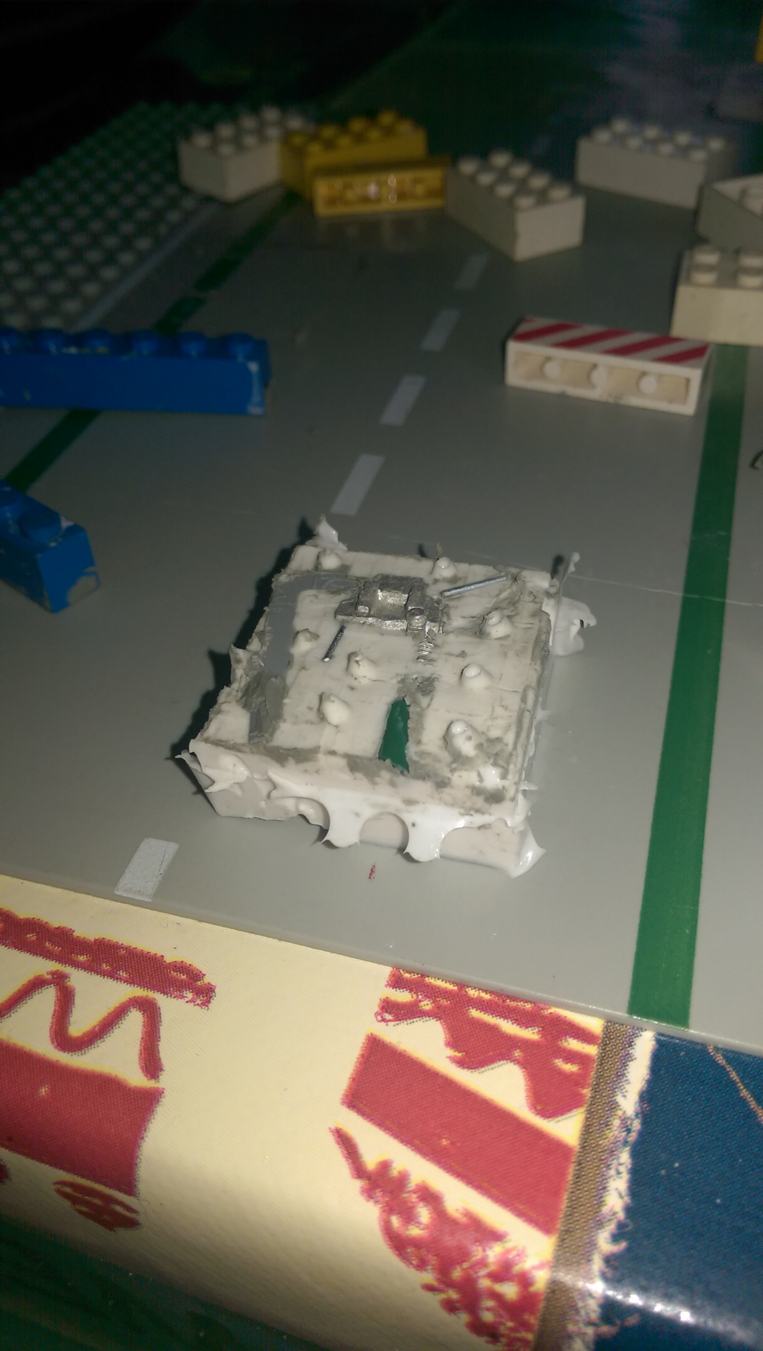

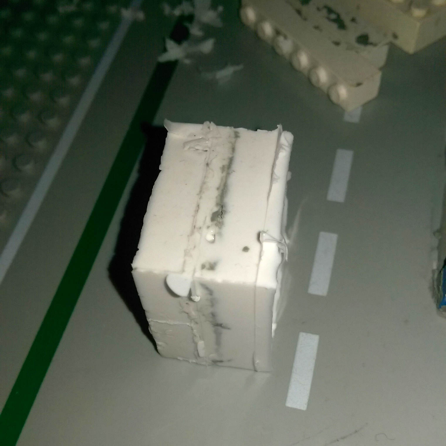

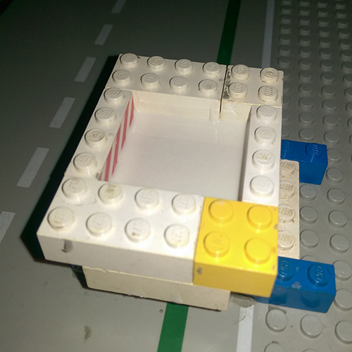

KRG-23 Posted June 5, 2015 Author Share Posted June 5, 2015 I'm not too sure about chopping up a Kasrkin to make those crusaders. I'd be more inclined to green stuff the armor bits on the fatigues, and that helmet isn't quite right for kasrkin.I totally agree, I don't want to lose time ripping appart a metal Kasrkin. I'll add some GS to the IG fatigues and make them look like Kasrkin, Karskin, err Kraskinwhatchamacallit... So, here is the follow up for the molding process : The pour, part 2 : http://www.krg-23.com/jeux/gw/images/bc/ETL4/th_IMAG0041.jpg The block : http://www.krg-23.com/jeux/gw/images/bc/ETL4/th_IMAG0042.jpg The tadaaam : http://www.krg-23.com/jeux/gw/images/bc/ETL4/th_IMAG0043.jpg Conclusion : I frakked it up. If you take a look at the 1st image, there is a sprue bit that would serve as the main spilling duct. I put it too close the side of the lego, there for now, at the bend, there is a hole ... Since I am in a test phase, I'll try to fix with rubber bands a piece of plastic card and will try to cast. An another hand, I pushed too hard on the backpack when molding the first half, therefore there are not much details on the second side of the mold ... Anyway, more soon, once I've done a few more progress. Link to comment https://bolterandchainsword.com/topic/308391-etl-iv-inquisitor-obeyron-sax-retinue/#findComment-4072453 Share on other sites More sharing options...
