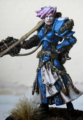

apologist Posted January 15, 2016 Share Posted January 15, 2016 Human eyes, or helmet lenses (or something else)? For human eyes, I tend to recommend painting the sockets with a very dark brown, then painting the face normally. Once dry, add a small horizontal stripe of black across each eye, and add a touch of pale cream (not pure white) to either side of each eye. This leaves the appearance of a pupil in the middle, without the 'staring' appearance the tends to result from dotting a black pupil in a white eye. That'll give you something like this: You can suggest expression by putting more white on one side of the eyes than the other, which results in the pupils being more to one side. If you've got more time, then by all means experiment with developing the area around the eye. Adding a hint of blue to the skin mix for bags under the eyes can be effective; and using a fine brown line above the eye helps suggest a eyelid. This is also a good way to remove a staring effect. The important thing is tonal contrast. This marine shows an eye painted with a simple dark tone – it's really just a patch of Charadon Granite mixed with black. It works particularly well for the all-black eye of Raven Guard. If your figure has very pale skin, it's best to glaze the area around the eyes with a red, purple or blue (depending on what effect you want) before you begin the eyes. Hope that helps. Link to comment https://bolterandchainsword.com/topic/318179-painting-eyes/#findComment-4276184 Share on other sites More sharing options...
