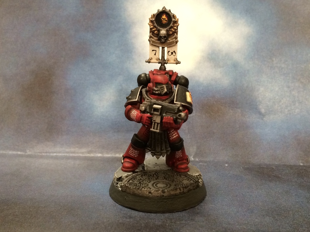

okonomiyakimarine Posted June 22, 2016 Share Posted June 22, 2016 I am so going to steal that vexilla color scheme of yours! If I may Also i'd love to know where that base is from or how you did it? Do you have a WIP thread for your BaC box? Link to comment https://bolterandchainsword.com/topic/323324-so-the-bac-transfers/#findComment-4426430 Share on other sites More sharing options...
