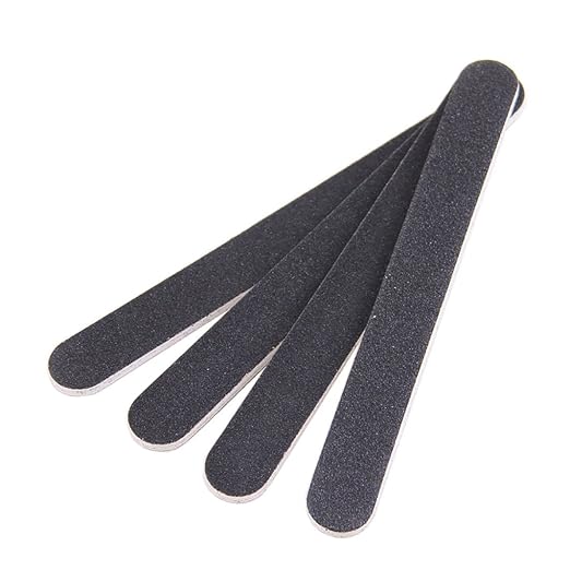

Elzender Posted January 23, 2017 Share Posted January 23, 2017 Major_Gilbear, could you show an image/picture of an emery board? Just to be it is the tool I think, being from different places means some times not the same things are available or as widely used :D Link to comment https://bolterandchainsword.com/topic/330198-needle-files/#findComment-4632492 Share on other sites More sharing options...
Major_Gilbear Posted January 23, 2017 Share Posted January 23, 2017 Major_Gilbear, could you show an image/picture of an emery board? Just to be it is the tool I think, being from different places means some times not the same things are available or as widely used Sure, no problem: Emery board = lima de uñas (for those who are Spanish speakers). ;) Link to comment https://bolterandchainsword.com/topic/330198-needle-files/#findComment-4632497 Share on other sites More sharing options...

Elzender Posted January 24, 2017 Share Posted January 24, 2017 Major_Gilbear, could you show an image/picture of an emery board? Just to be it is the tool I think, being from different places means some times not the same things are available or as widely used Sure, no problem: SNIPPETY-SNIP Emery board = lima de uñas (for those who are Spanish speakers). Thanks ! I searched for "emery board" and found those, which was what I thought, but I've learnt to not assume the same things are used everywhere, and the ones I normally see around here look a bit too rough and abrasive, so I wanted to make sure. Guess I'll have to "borrow" one from my significant other to give it a try Link to comment https://bolterandchainsword.com/topic/330198-needle-files/#findComment-4632635 Share on other sites More sharing options...
