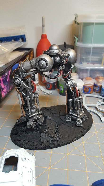

Guiltysparc Posted February 2, 2017 Share Posted February 2, 2017 I may be off the mark on your question here, but i've hit on a very easy metal process if thats what you are going for. Spray leadbelcher All over nuln oil wash Heavy drybrush leadbelcher Light drybrush of ironbreaker Very light drybrush of runefang just over some of the more pronounced edge Stippling of runefang over the broader surfaces like the hip joints and such Here is an exmaple of it on the knight i'm working on now. On this particular example i did a heavy drybrush of ironbreaker and runefang over the bits of the pistons that seem like they would move in and out of something to give it a cleaner look. Link to comment https://bolterandchainsword.com/topic/330235-painting-silvery-vehicles/#findComment-4641215 Share on other sites More sharing options...
