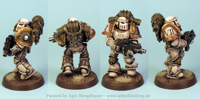

Herald of Magnus Posted February 23, 2017 Author Share Posted February 23, 2017 http://www.agisn.de/HH_DG_Test_1.jpg This is the kind of scheme I'm looking for. Though like I said the WIP models I've got so far have copied the forgeworld scheme etc and don't seem to be working. Though I've not done any highlights yet (bit nervous to do so) but the armour seems quite off. Misterkho that's the scheme I followed so far. I've not gone past dry brushing the pallid Wych flesh so basically I haven't highlighted it yet but it still looks a bit odd. The original guide I read with that scheme said to heavily drybrush the Wych flesh so I tried that but I think I ended up doing it way too heavy. Will adding the white highlight and the rust really bring it together? :S Edit: that pic I posted I really like but I do like the more boney colour of Wych flesh as a Base it's quite nice? Link to comment https://bolterandchainsword.com/topic/331298-death-guard-and-painting-help/#findComment-4664219 Share on other sites More sharing options...
Major_Gilbear Posted February 23, 2017 Share Posted February 23, 2017 I assume that since you've linked to his picture, you've also read Agis' tutorial on how he paints them? Link here, scroll to the bottom. Another classic military modeller's technique that might suit you is actually based less on painting, and more on cleaning! Simply put: 1) Prime white with a good automotive primer. Keep it thin and smooth. 2) Basecoat with a light ivory of your choice. Two or three runny-thin coats, applied so that they don't pool. It's important to get a nice even colour, and no lumps or rough bits. 3) Gloss varnish the model. Let this dry somewhere warm for at least 24hrs. 4) Wash the whole model with a little bit of brown artist's oil paint thinned with some white spirit. Let this dry for a few hours. 5) Using a small soft sponge (the sort ladies use for makeup, like this one, are excellent for this) and some white spirit, carefully wipe off the brown paint, leaving it in the recesses. You'll also get a little bit of faint streaking, which looks fine and adds further character. Leave the model to dry (this may take over a day, so plan accordingly). 6) Seal the model with a decent matte varnish, and set aside to dry. You can can then finish any other details as you'd like, and re-seal at the end. You can also apply some of the colours like the green and gold before the brown wash if you want to weather them all together, and likewise, applying any transfers before you varnish and weather will help them blend right in. You can also add further chips and scuffs as you wish, but I find a mucky ivory is a good compromise for the DG; their classic MkIII armour is pretty busy with trim and rivets, and so adding too much weathering and scuffing tends to drown out the model very quickly IMO. The main benefit of applying and then wiping off the weathering is that it's fast - you don't need to go back and re-paint or re-highlight anything. Similarly, the weathering not only shades all the recesses, but also provides some nice streaks and grime effects. For what is otherwise a difficult colour to paint (i.e., essentially a warm white), this is an even greater boon! Finally, I might suggest checking out some painting tutorials fro Death Guard on YouTube. As well as the official GW painting tutorial on their channel (WarhammerTV), there are lots by other painters who have posted all sorts of tutorials up of their own efforts. Seeing somebody actually paint the models instead of just viewing still photos can be extremely helpful in understanding what you're trying to do, and will assist you greatly in terms of gauging paint thickness, application, technique, etc. Edit: links fixed Link to comment https://bolterandchainsword.com/topic/331298-death-guard-and-painting-help/#findComment-4664240 Share on other sites More sharing options...
