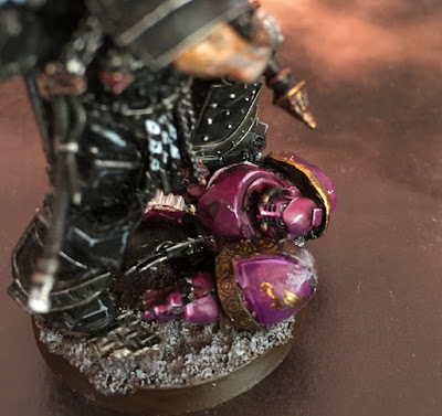

apologist Posted May 17, 2017 Share Posted May 17, 2017 I like the Imperial purple approach, too, and used something in-between the two (beautiful!) examples Kizzdougs posted above on my Ferrus conversion. My two pence is that, in the context of a diorama, you want to keep the purple slightly more muted than you might otherwise, or they'll steal all the attention. Link to comment https://bolterandchainsword.com/topic/333688-emperors-children-paint-scheme/#findComment-4744630 Share on other sites More sharing options...
Luna707 Posted May 17, 2017 Author Share Posted May 17, 2017 Wow Apologist, I never noticed the swirling detail work on the casualty's pauldron before. That is a very cool detail, I'll have to try something like that on my EC. The EC aesthetic is so departed from what I'm used to, I'm going to have to start thinking outside of the box! Link to comment https://bolterandchainsword.com/topic/333688-emperors-children-paint-scheme/#findComment-4744645 Share on other sites More sharing options...
