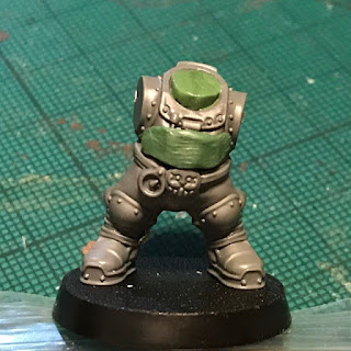

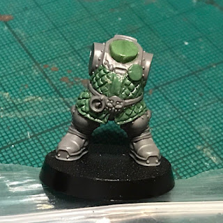

apologist Posted April 30, 2018 Share Posted April 30, 2018 This is a tutorial to convert the Kharadron Arkanuts into Rogue-Trader inspired squats like this: The images and full tutorial can be found on Death of a Rubricist here. I_ Mix up your putty and apply it over the torso, aiming to fill the space between the collar and belt as shown. You don't need a huge amount. + Note that I've filled the neck area; that's because I'm using a flat-bottomed head from the Hammerer/Longbeard kit. Depending on which heads you're using, you may or may not need to do this. + II_ Use the smooth end of the sculpting tool to spread out the putt evenly over the area, working into the crevices. Leave a fine gap at the edges. If you've added a little too much putty, simply smooth it so that it overflow the area, then use the sharp edge of the sculpting tool to trim it away neatly. III_ Use the smooth end of the tool to gently push the surface of the putty towards the middle. This will create a raised hump, which you then gently flatten to create the impression of a strap. Note that the arkanaut bodies vary – some have two straps. You can sculpt them how you wish, but there are buckles on the collars that provide handy guidance on the placement of the straps, and help you to ensure a uniform thickness. IV_ Use the blade of the sculpting tool to draw diagonal lines. Keep them as evenly-spaced as you can, and avoid the strap. V_ Work back the other way, making diagonal lines running in the opposite direction to create the quilted effect. VI_ Roll a tiny ball of putty and place it on the upper left chest. VII_ Use small circular motions of the smooth end of the tool to gently flatten out the ball into a circle. This will be the regimental/thronghold badge. VIII_ Use the craft knife to trim away the little bobble at the back of the neck (the part where the backpack is intended to attach). Next, lay a small amount of putty between the belt and collar at the back, just like in step I. IX_ Repeat the quilting process (steps II–V above) on the back, then add a small ball of putty where you trimmed away the backpack attachment. Smooth it out into a rough rectangle, then use the flat edge of the tool to refine and sharpen the edges. X_ Returning to the front, wrap a small amount of putty around the upper legs, just below the belt. Smooth this into a flat tunic. As you can see, I didn't add enough putty initially, so it doesn't wrap all the way round (you can see the unsculpted end on the left of the picture). It's better to work gradually and add a little more at a time; as it's easier to add and smooth in small amounts than trim away excess neatly. XI_ Once you have laid in the basic shape, repeat the quilting to pattern the bottom of the tunic all the way round the body. Because there's no break between the front and back, you can work round in one go. Try to match the spacing of the squares you're creating to the size of the existing quilting on the front and back. XII_ Gently run the blade of the sculpting tool round the edges of the tunic bottom to create a border. Use the smooth end of the tool to gently erase any overlapping marks to finish. Link to comment https://bolterandchainsword.com/topic/346748-converting-squats-from-kharadron-arkanauts/ Share on other sites More sharing options...
