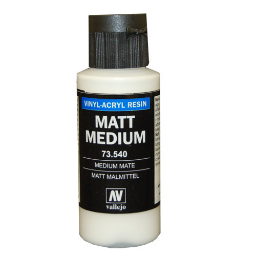

appiah4 Posted January 8, 2019 Author Share Posted January 8, 2019 Airbrushing is not an option, neither have the room or time to invest into it.. I guess I will have to go with some kind of specialized thinner. Any alternatives to Matte Medium? Something I can buy in larger quantities for cheap would be nice. Another issue I have with Vallejo paints is that they dry incredibly fast on the brush.. Is this also normal? The more I think about it the more it feels like I picked the wrong colors to work with :) Link to comment https://bolterandchainsword.com/topic/352983-working-with-vallejo-game-color-thinning-question/#findComment-5230685 Share on other sites More sharing options...
Imren Posted January 8, 2019 Share Posted January 8, 2019 Perhaps try out vallejos own stuff (get them in the 60 ml dropper bottles instead of the regular 17 ml dropper bottles, that will be cheaper in the long run): https://www.miniaturemarket.com/media/catalog/product/cache/1/image/9df78eab33525d08d6e5fb8d27136e95/v/a/val73540.jpg and for the quick drying you'll need this: https://proxy.duckduckgo.com/iu/?u=https%3A%2F%2Ftse3.mm.bing.net%2Fth%3Fid%3DOIP.lVVIBr5niqyF9jMVQ9IXKAAAAA%26pid%3D15.1&f=1 Link to comment https://bolterandchainsword.com/topic/352983-working-with-vallejo-game-color-thinning-question/#findComment-5230700 Share on other sites More sharing options...

appiah4 Posted January 9, 2019 Author Share Posted January 9, 2019 I am somnewhat confused by the amount of additives and extenders Vallejo has in their range.. My main issue is that watering down my paint to a consistency that will let me paint thin coats results in brush streaks and blotchiness - do I need a matt medium or thinner medium to thin my paint instead of water? What is the difference? Link to comment https://bolterandchainsword.com/topic/352983-working-with-vallejo-game-color-thinning-question/#findComment-5231902 Share on other sites More sharing options...
Imren Posted January 10, 2019 Share Posted January 10, 2019 You want (matt) medium, because it contains more acrylic binder compared to thinners. Most acrylic thinner is all a mixture of IPA (isopropyl alcohol), water, fluid retarder and flow improver. However, some thinners have binders in them as well, you can usually see this as they are more opaque, for example the regular vallejo thinner has some binder in it but less than the matte medium, but vallejo airbrush thinner has no binder in it instead just IPA, fluid retarder and flow improver (whats needed when airbrushing) since when airbrushing you get a more uniform dispersion of paint over the surface compared to painting with paintbrush and therefore no need for binder (thats why when airbrushing thinning with water and alcohol works as good as thinning with medium).So to answer you question, get the matt medium. Link to comment https://bolterandchainsword.com/topic/352983-working-with-vallejo-game-color-thinning-question/#findComment-5232096 Share on other sites More sharing options...

Imren Posted January 10, 2019 Share Posted January 10, 2019 you're welcome, good luck with you vallejo paints! Keep one thing in mind when diluting your paint with medium only: The medium does not evaporate completely when drying, so it will leave some solid layer of its own when dried and this will add up with your paint when mixed. so your paint will be thicker compared to diluting with thinner or water, so when you paint with a mixture of paint and medium what you have done is essentially maintained the ratio between solidifying chemicals (pigments and binders) and evaropating ones (water and alcohols) but reduces the concentration of pigment. So you do run the risk of covering up details with more transparent solidified paint layers (with less pigment) if you dilute with medium only. I advice that you still thin your paint with a wee bit of water in add medium and focus on doing thin layers. The first layers will be blotchy but the third and fourth layer will havfe enough pigment covering the surface in a uniform way so that you get a good coverage. Link to comment https://bolterandchainsword.com/topic/352983-working-with-vallejo-game-color-thinning-question/#findComment-5232124 Share on other sites More sharing options...
