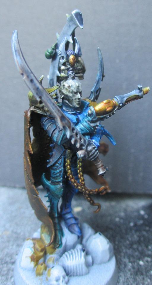

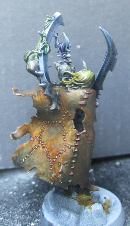

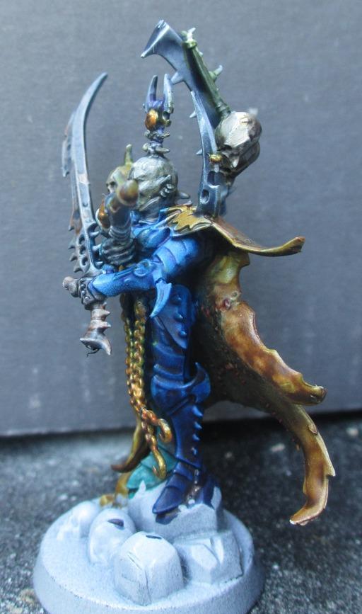

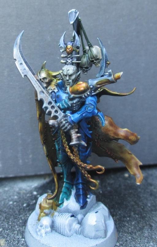

Kua Posted June 9, 2019 Share Posted June 9, 2019 (edited) Alright, if you don’t mind. ^^ You can call the thread whatever you like, ofc. I spent yesterday evening in a GW store with some of the paints. Unfortunately the Contrast Medium was not included, but instead I got to grab a more interesting test model than some starter box content. It was still considered a test model, but there was in incentive to try to get with it somewhere instead of just regarding it as a surface to put paint on. It’s neither clean not finished, ofc., but I tried different techniques on places where they would make sense. The model is almost entirely painted with Contrast, except the head (that became dark and ugly and I just slapped some white on it). Result no. 1 is, that Contrast is really good for wet blending if you are quick. It dries pretty fast, so there is little time for being accurate, but on the other hand it allows you not to. I recommend starting with the lighter tone and adding the darker one (for the lower regions) in the second step, instead of vice versa, judging by its flowing and mixing properties. Almost every surface of the model has at least 2 different Contrast colours on it, blended one into the other. Result no. 2 is that contrast on metallics works really well. We probably already knew it from youtube, but I can confirm it now. Here I used a very much thinned down (a friend had some Vallejo Flow Improver I could use instead of the medium) Black Templar Black to add this tiny last bit of depth in an additional step in the end. I think this additional step with a thinned darker Contrast (or maybe just a wash, didn’t try) is something you’ll be often using after the lighter Contrast colours. As it is, I consider the white Contrast not useful, but maybe one can make it work this way, too. This was result no. 3, btw. Result no. 4 would be the dabbing (if I’m not mistaken about the correct English term) you can see on the lord’s coat. It was done with Contrast, too, but with partly different colours. Since the difference between Contrast and a half-dried wash is it’s oily flowing properties, you can make some use of it this way. Ofc, unlike oil, it will still dry almost instantly, but look smoother with dabbing than normal Layer colours. Result no. 5 is that with a dissolver (e.g. spirit) you can solve contrast before the underlying coat of colour, but it is not as easily removed with a brush, but turns into a glaze instead. You can still mostly remove it, ofc., but you keep a changed colour tone. Result no. 6 is that the new contrast basecoat (Grey Seer and the other one) in their bottle variants are useless liquids that you should never buy, and if you already did throw away and save some nerves. So far my results yesterday. Edited June 9, 2019 by Kua N1SB and Bryan Blaire 2 Back to top Link to comment https://bolterandchainsword.com/topic/356485-initial-contrast-experiments-from-us-all/#findComment-5328732 Share on other sites More sharing options...

Spacecow Posted June 9, 2019 Share Posted June 9, 2019 @Kua : any idea how it react on thinners that are not GW? Or retarders? Curious how far you can push the paint. Link to comment https://bolterandchainsword.com/topic/356485-initial-contrast-experiments-from-us-all/#findComment-5328745 Share on other sites More sharing options...
Kua Posted June 9, 2019 Share Posted June 9, 2019 @Kua : any idea how it react on thinners that are not GW? Or retarders? As I said, I had some Vallejo flow improver there, using as thinner for this purpose, and it kind of worked. I can’t compare to Contrast Medium because I couldn’t try it. But water is really bad in combination with contrast, you do need some thinner. Link to comment https://bolterandchainsword.com/topic/356485-initial-contrast-experiments-from-us-all/#findComment-5328751 Share on other sites More sharing options...
Spacecow Posted June 9, 2019 Share Posted June 9, 2019 That’s what I thought but GW keeps showing in videos the use water. Also very hard for me to get my head around the one thick coat considering the pooling. But I guess they are trying to keep it as accessible as possible. Link to comment https://bolterandchainsword.com/topic/356485-initial-contrast-experiments-from-us-all/#findComment-5328755 Share on other sites More sharing options...
