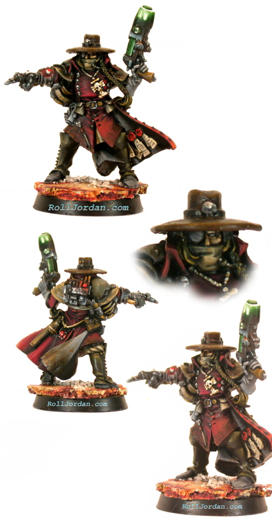

Brother-Chaplain Kage Posted June 24, 2019 Share Posted June 24, 2019 It could be the pictures, but the immediate issue to me is how desatured all the colors are and everything looks a bit... muddy. A problem I have, but am getting better with now, is doing paint schemes with desaturated colors and only small amounts of contrast which look great when I'm holding it 6 inches from my eyes to paint. At arms' length or from across the table, all of that subtle shading, highlighting, and contrast just disappeared and the model looked like a dark lump. As an example, here's an inquisitor of a different kind using a similar color palette as yours, but with much more contrast and brighter colors. If you're set on using a dark palette with desaturated colors, contrast will be very important and you'll need at least one bright accent color somewhere, but I'd suggest a brighter scheme. After all, Inquisitors tend to have very ostentatious outfits that are just as much a psychological weapon as the power armor of a space marine; they stand out in a crowd. I also think Lorr works better with his entire upper and lower storm coat the same color (unless you're going to use two highly contrasting colors) but there are only a few painted examples I could find like that and this one I liked the best. I recently made a post on my WIP thread about using a color harmony website to help me with the paint scheme for my Orlock gang and it might help you with this as well. Link to comment https://bolterandchainsword.com/topic/356773-need-some-help-with-inquisitor-model/#findComment-5336571 Share on other sites More sharing options...
