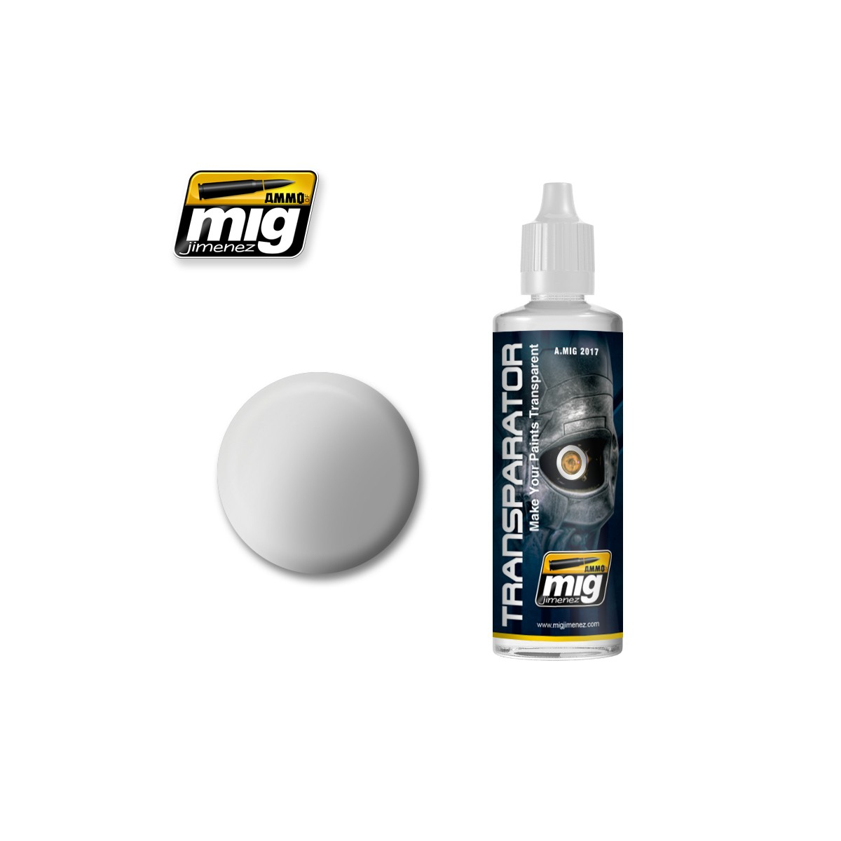

Bung Posted July 14, 2019 Share Posted July 14, 2019 Well, your pre shading lacks alot of contrast and maybe you sprayed your ionrach Skin to oppaque. If you spray over pre-shading your paints need to be realy transparent like thinned washes or like Tamiya Clear Colors. The colors should work like looking through a lighly tinted glass. For me, Mr. Surfacer 1200 is a bit to light of a grey. For a tabletop standard i prime with a mix of 2:1 Black / White mix (I use MIG One Shot Primer or Stynylrez which is the same) Then i set first highlights with a medium grey like 1:1 Black / White Next step is a highlight with a light grey like 1:2 Black / White (For the 2 steps you can use a pre mixed grey what you have already, no need to mix) Wash with black either the recersses or the whole miniature, depending if you want a darker tone. Set top / edge highlights with white. Optional step: add battle damage like sponge chipping etc. Spray your main color. For alot of paints i use MIG Transparator to thin them down to a transparent level. Remember those Vase colors of GW are really oppaque so i would thin them at least 10:1 to get them transparent to work with pre shading Link to comment https://bolterandchainsword.com/topic/357147-preshading-advice/#findComment-5346983 Share on other sites More sharing options...
