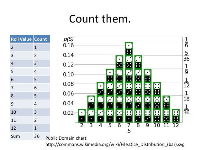

Marshal Reinhard Posted August 1, 2021 Share Posted August 1, 2021 (edited) d12 is the same as the d6 in that each number is exactly as likely an outcomes as any other, ie 1/12 or about 8.33%. There's no bias towards low or high numbers with 2d6, you again get a bell curve with the ends (2 and 12) being the least likely (1/36 or about 2.77%) because they have the fewest possible combinations, while 7 being the center has the most and thus is the most likely at (6/36 or 16.66%) Here's some graphic i yoinked off the internet: The two take aways for any of these situations is: the 2 dice has a slightly higher average than the single variant (4 vs 3.5 in the case of 2d3 vs 1d6, 7 vs 6.5 in the case of 2d6 vs 1d12). This is due to the fact that the distribution does not include the result for 1. The 2 dice distribution is a bell curve vs a flat distribution for the single dice, this means the 2 dice have a higher chance to get the middle result vs the single dice where every result is as likely as any other. On a whole in the game it's prefferable to have 2d3 to 1d6 (or 2d6 vs 1d12) if you want to roll consistently higher results. You're rolling higher on average, and you're guarded against ever getting the lowest result. If you want the very top result as frequently as possible though, 1d6 (1d12) may be prefferable. Edited August 1, 2021 by Reinhard Ryltar Thamior and LameBeard 2 Back to top Link to comment https://bolterandchainsword.com/topic/371163-2d3-vs-d6-is-there-a-difference/#findComment-5725429 Share on other sites More sharing options...
