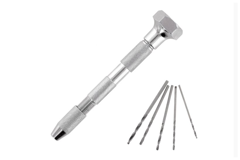

Lord_Ikka Posted December 3, 2021 Share Posted December 3, 2021 (edited) The older pin vise, like above, works decently and I used to have it as my main tool for drilling. Now however, I've drifted to using one similar to the linked below, which uses a integrated three-claw chuck rather than the older's detachable chucks. I've found it grips better and works for any bit that I use. https://www.amazon.com/AUTOTOOLHOME-Precision-Model-Drill-Twist/dp/B010BV7190 Edited December 3, 2021 by Lord_Ikka andes 1 Back to top Link to comment https://bolterandchainsword.com/topic/372469-magnetizing-and-drill-bits/#findComment-5769268 Share on other sites More sharing options...
