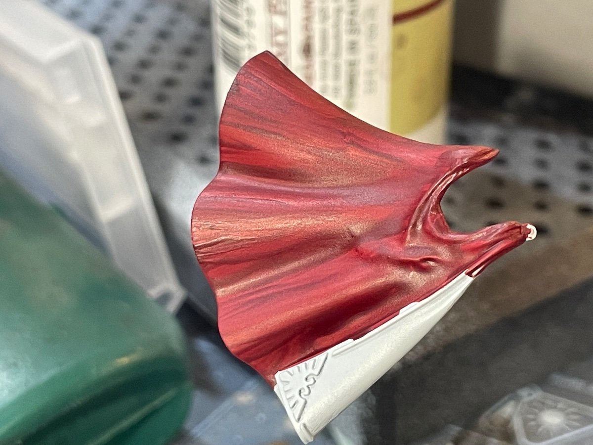

crimsondave Posted 14 hours ago Share Posted 14 hours ago Can someone tell me why this happens to me so often when I use contrast paint? Sometimes it looks great. Others it’s this garbage. I don’t get it. That’s Flesh Tearers red. I’ve used it before with good results. Spoiler I just stripped it and will use regular paint. Link to comment https://bolterandchainsword.com/topic/385725-contrast-paint-help/ Share on other sites More sharing options...
Grotsmasha Posted 10 hours ago Share Posted 10 hours ago This happened to me with Flesh Tearers red too. Specifically, when the pot was low, less than a quarter left, and left the lid open too long while I painted. I feel like it was / or had dried out. If you have Contrast Medium, add some in and give it a solid shake, or, buy a new pot. Additionally with Flesh Tearers, I regularly close and shake it during paint sessions. crimsondave 1 Back to top Link to comment https://bolterandchainsword.com/topic/385725-contrast-paint-help/#findComment-6105927 Share on other sites More sharing options...
crimsondave Posted 10 hours ago Author Share Posted 10 hours ago (edited) 27 minutes ago, Grotsmasha said: This happened to me with Flesh Tearers red too. Specifically, when the pot was low, less than a quarter left, and left the lid open too long while I painted. I feel like it was / or had dried out. If you have Contrast Medium, add some in and give it a solid shake, or, buy a new pot. Additionally with Flesh Tearers, I regularly close and shake it during paint sessions. I suspect you are right, but I did add contrast medium. I guess not enough. Dark Angels green is very hard for me to use too. Edited 10 hours ago by crimsondave Link to comment https://bolterandchainsword.com/topic/385725-contrast-paint-help/#findComment-6105930 Share on other sites More sharing options...

sbarnby71 Posted 6 hours ago Share Posted 6 hours ago One thing I'm seeing in the picture is where a very thick area of paint looks like you pulled a brush through it leaving the dried raised bits. I've done that so many times. When I use contrast I thin it a lot and do 2 layers minimum and allow them to dry for ages in between. Another thing on a big bit like that cloak I would do it in sections based on the creases and make sure you don't get too much pooling before you move to the next section. Contrast is tough to get right (well for me anyway). Firedrake Cordova 1 Back to top Link to comment https://bolterandchainsword.com/topic/385725-contrast-paint-help/#findComment-6105945 Share on other sites More sharing options...
tychobi Posted 12 minutes ago Share Posted 12 minutes ago Thin your paint with a touch of water and it should regain its ability to flow. Contrast needs mixing and thinning just like a regular paint. Link to comment https://bolterandchainsword.com/topic/385725-contrast-paint-help/#findComment-6105980 Share on other sites More sharing options...
