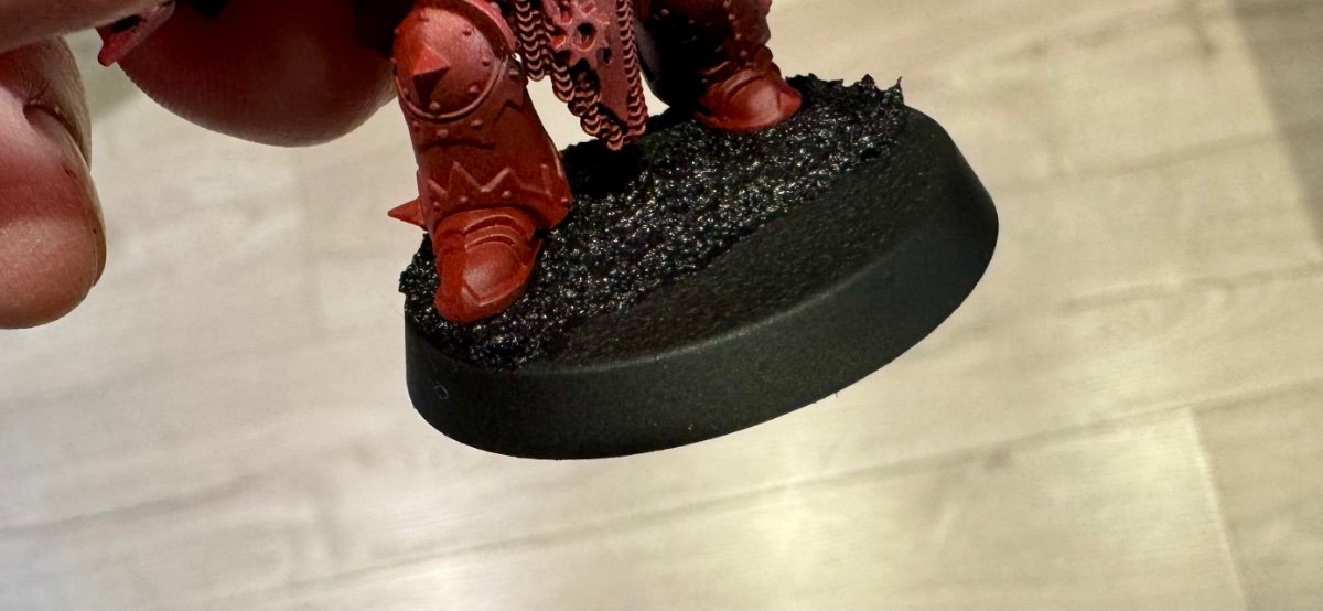

jimbo1701 Posted May 4, 2025 Share Posted May 4, 2025 Greetings brothers / sisters. I have myself in a bit of a quandary trying to decide what product to use for a basing project and was hoping for some advice before investing in products to try. I’ve tried YouTube and scouring the internet to little avail. The basing theme is ‘lava’ but with rivers of blood rather than molten rock. I’ve used Vallejo lava effects over a black primed base and am now looking to add the ‘blood’ effect. I envisage this being a resin product tinted red but having looked at a range of products but I’m unsure what’s best to use. Ideally it needs to be something that would self-level when placed in the empty area on the base so as to look like a static pool rather than waves etc. Also it would be ideal if it would be turbid enough to not bleed over the edges of the base rims to save me having to mask them. Only needs to be 1-2mm thick and opaque red. Any suggestions gratefully accepted. Cheers. N1SB and Firedrake Cordova 1 1 Back to top Link to comment https://bolterandchainsword.com/topic/385791-need-help-with-liquid-effects-on-base/ Share on other sites More sharing options...

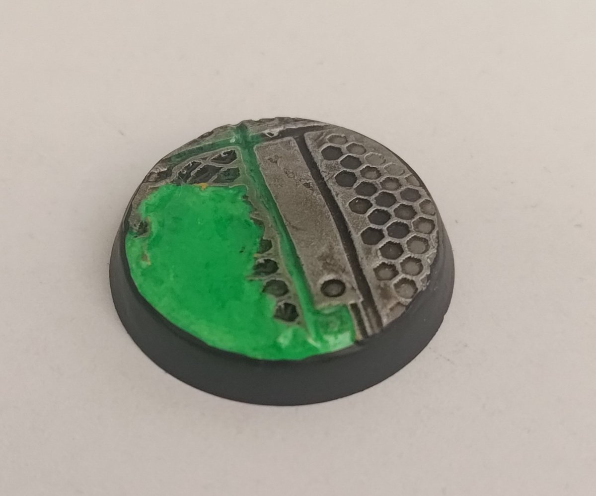

Madao Posted May 5, 2025 Share Posted May 5, 2025 (edited) I am using https://ak-interactive.com/product/water-gel-transparent-250ml/ - it is gel, but there is no problem with leveling. You can mix some ink in it to make it colourful. Beware - you want way less than you think AND I had issues when mixing Liquitex ink (I was able to mix some other brands, so results may vary). You need to paint the base below it though - it won't cover much. For strong, vibrant colours go with white (almost all area, but leaving just the edges) and then some nice, 'fluorescent' ink over it (several coats will be needed to cover the white). Then water effect gel on top of that with or without some ink mixed in. It took me several ruined bases (most of them were test ones, but still) to be anywhere near being happy with the result. Generally you want to keep the gel layer thin and (even though you prefer to have it still) do some unevenness on larger areas, otherwise they are just... flat and boring EDIT: gel has one enormous advantage over the poured resin - it does not spill, so you don't need to create any form of mold at the base rim Edited May 5, 2025 by Madao jimbo1701 and Firedrake Cordova 1 1 Back to top Link to comment https://bolterandchainsword.com/topic/385791-need-help-with-liquid-effects-on-base/#findComment-6108043 Share on other sites More sharing options...
