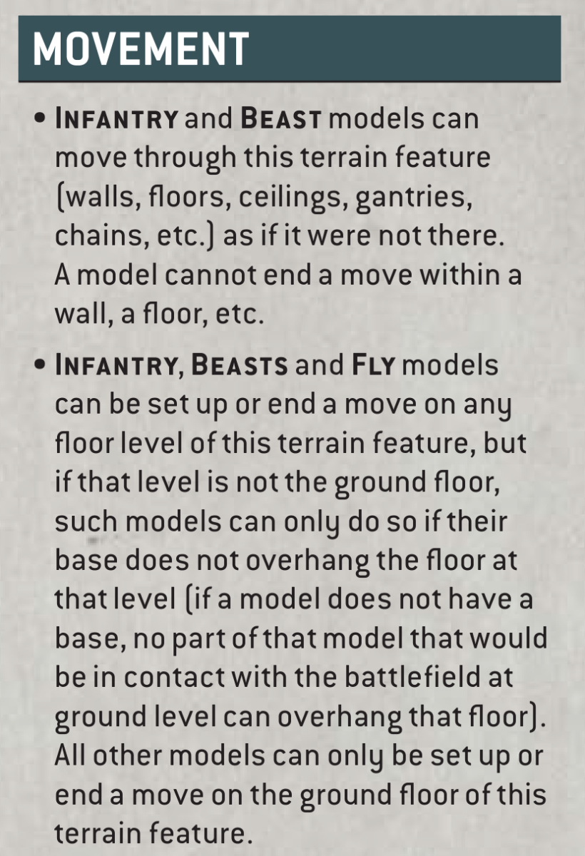

kabaakaba Posted May 20, 2025 Share Posted May 20, 2025 Hm, I rechecked core rules and there is this thing in terrain section regards ruins exactly Doesn't it counters the rules about movement up and down? Dr_Ruminahui 1 Back to top Link to comment https://bolterandchainsword.com/topic/385944-moving-over-terrain-features/#findComment-6111040 Share on other sites More sharing options...
Dr_Ruminahui Posted May 20, 2025 Share Posted May 20, 2025 For infantry and beasts, yes, if its ruins. For other models (say, a vehicle or mounted), the exception wouldn't apply and the rules would require (IMHO) the vertical movement as well. Link to comment https://bolterandchainsword.com/topic/385944-moving-over-terrain-features/#findComment-6111041 Share on other sites More sharing options...
