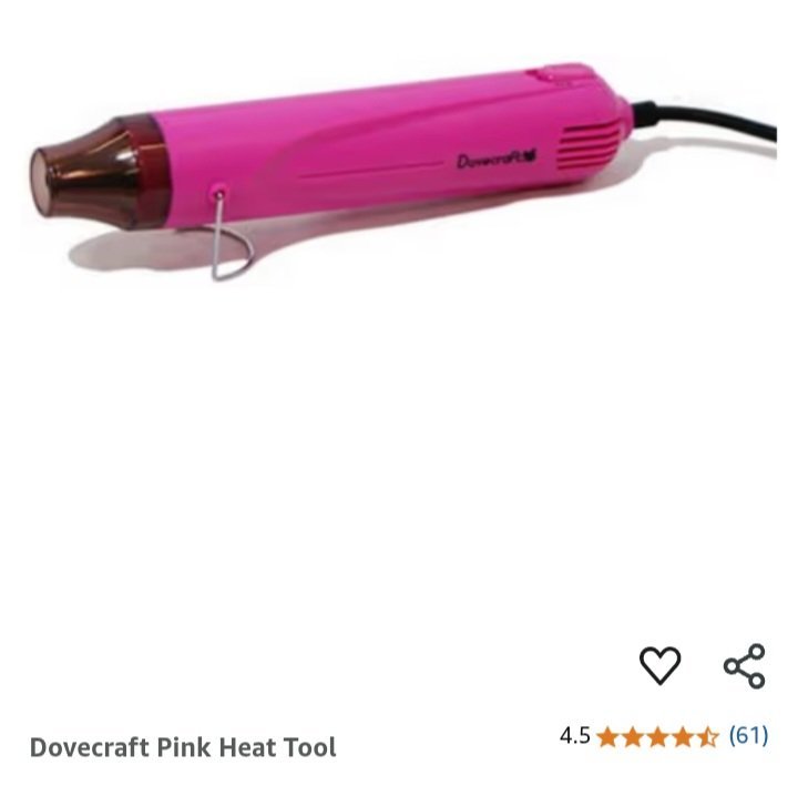

skylerboodie Posted June 11, 2025 Share Posted June 11, 2025 I can't recommend one of these heat tools enough, so much easier than water baths or hair dryers for working with resin, makes reshaping pieces so simple and easy. Alby the Slayer, N1SB and StratoKhan 1 1 1 Back to top Link to comment https://bolterandchainsword.com/topic/386108-cashing-in-my-forgeworld-v-card/#findComment-6115482 Share on other sites More sharing options...

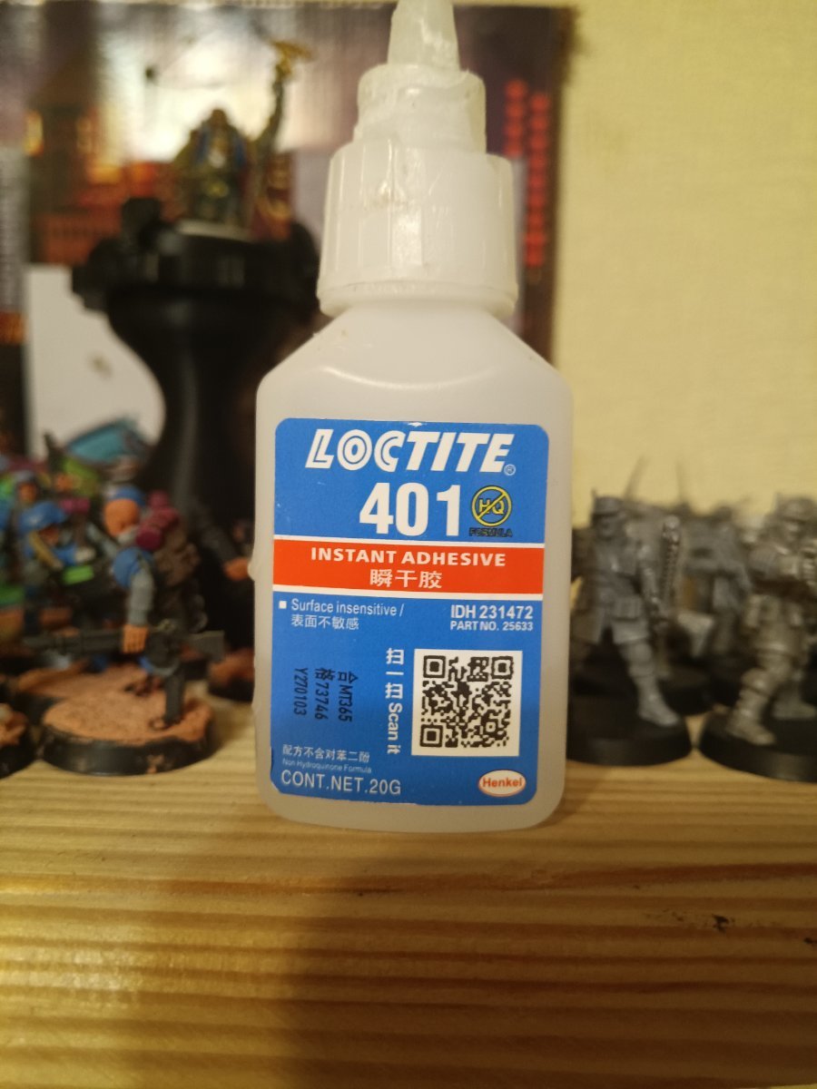

kabaakaba Posted June 15, 2025 Share Posted June 15, 2025 (edited) If you interested, I use loctite 401 glue. It's liquid, but really strong and easy to work with. My current army of 1500 point IG is all-resine. Even Valkyrie. It's works super fine for me. Also don't forget your favorite putty like Tamia putty white for example. Edited June 15, 2025 by kabaakaba Link to comment https://bolterandchainsword.com/topic/386108-cashing-in-my-forgeworld-v-card/#findComment-6116447 Share on other sites More sharing options...
