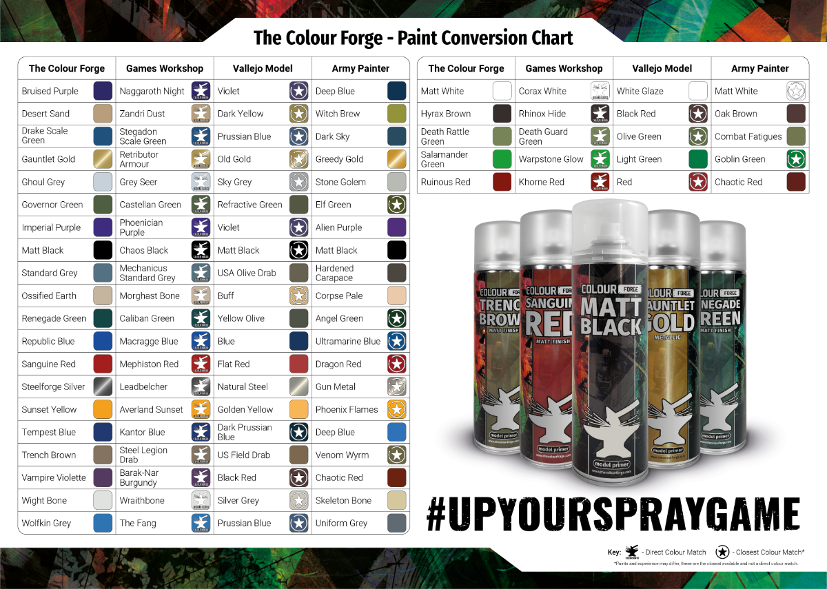

Uprising Posted September 6, 2025 Author Share Posted September 6, 2025 Looking at there old conversion chart, it looks like Matt White would work. Is this correct I wonder? Sonder76 and Viridia 2 Back to top Link to comment https://bolterandchainsword.com/topic/386648-alternative-to-games-workshop-citadel-corax-white-spray-paint/#findComment-6131165 Share on other sites More sharing options...

WBRBloom Posted September 8, 2025 Share Posted September 8, 2025 On 9/7/2025 at 9:26 AM, Sonder76 said: You could get a really cheap airbrush from amazon. They do basic ones that are hand held and run of a recharge battery. With that you could just spray Corax White from the pots. I have a friend that uses one and they are really good for the basics of base coating in batches. The one in the image is close to what im talking about and costs about £25 in the UK. Search for Mini Airbrush Kit. Yeah, I'll second that. If you want to 'match' the corax white effect, your go to solution would be with a cheap airbrush (if you don't have one already) and the paint out of the pot. Alternatively, you can try the Duncan Rhodes 'Trooper White' which is the Corax White equivalent and Duncan promotes these as the GW replacement/equivalents (again, the application using an airbrush stands): Conversion-Chart-Wave-1_2023_01.pdf Sonder76 and Firedrake Cordova 2 Back to top Link to comment https://bolterandchainsword.com/topic/386648-alternative-to-games-workshop-citadel-corax-white-spray-paint/#findComment-6131285 Share on other sites More sharing options...
