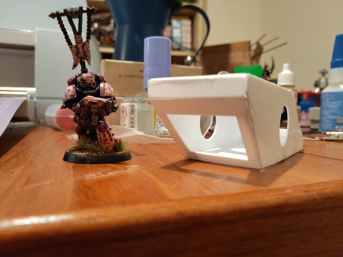

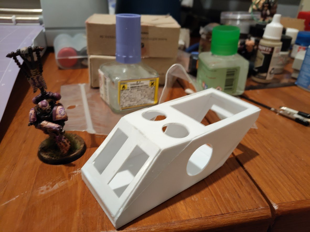

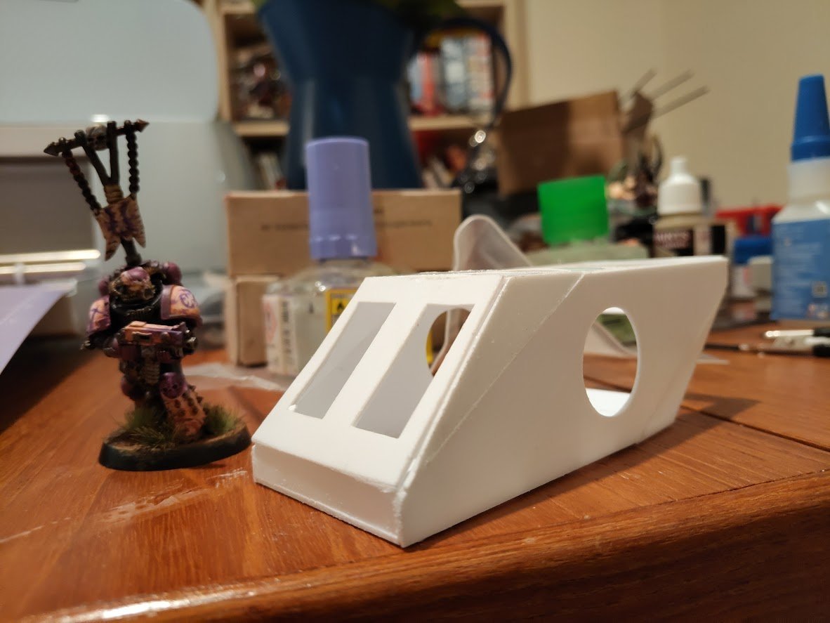

So! I had a go at making my own template for the core hull of a Mk. 1 Rhino, using Blender and a paper model addon to design it. After much faffing about with working out how to get it to export properly, then messing with settings in Cricut Design Space (I would recommend the engraving tip with the 1mm acrylic preset, more pressure, and running the same pattern around 4 times without unloading to get nice deep scores) I achieved results! Good ones even! Pictured here are the initial fruits of my labour, with an almost finished Ogre Brethren Chaos Marine for scale.
IMG_20251028_212116.thumb.jpg.1354e2808c7ad40b1d5bdbd4d4dcbb51.jpgIMG_20251028_212120.thumb.jpg.66297f94c5d6c864c0fda1f926d9637e.jpgIMG_20251028_212131.thumb.jpg.378304cbf21f71a9f8bdf4b5bc8f08f1.jpg
My gluing skills require some polish, and I need to be a bit more careful when removing the parts from the sheet, but that aside I'm very pleased to say the basic theory works!
