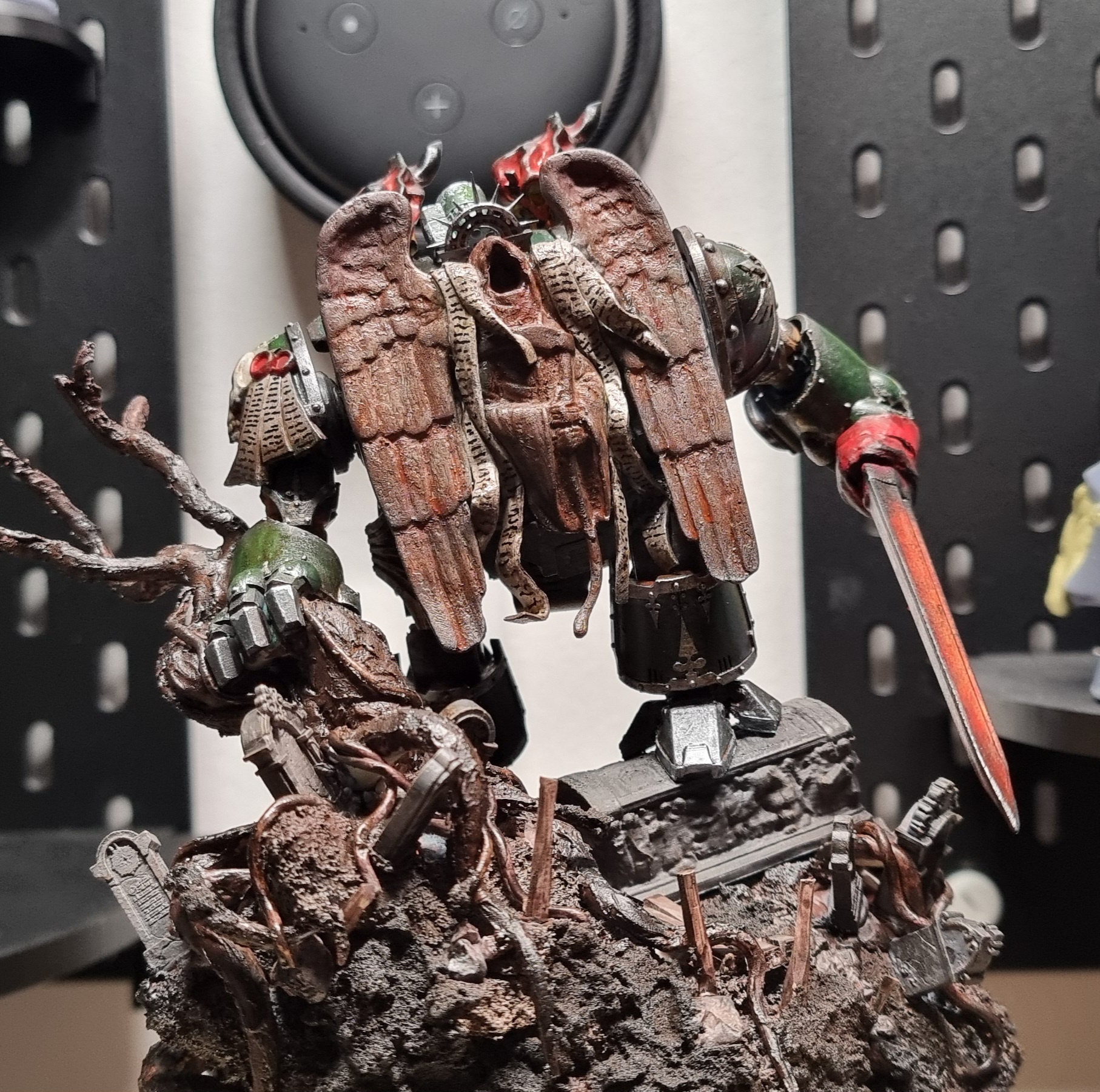

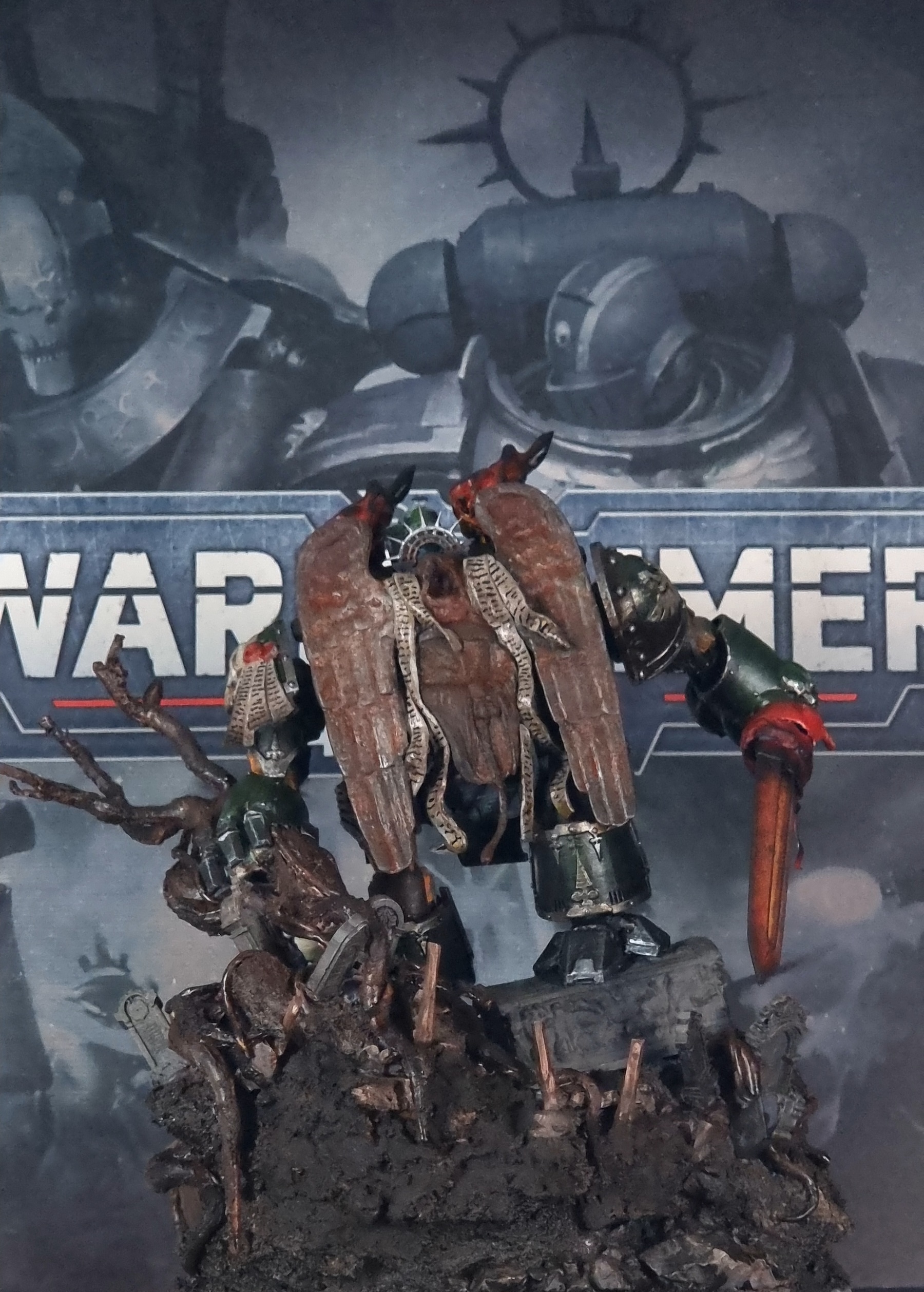

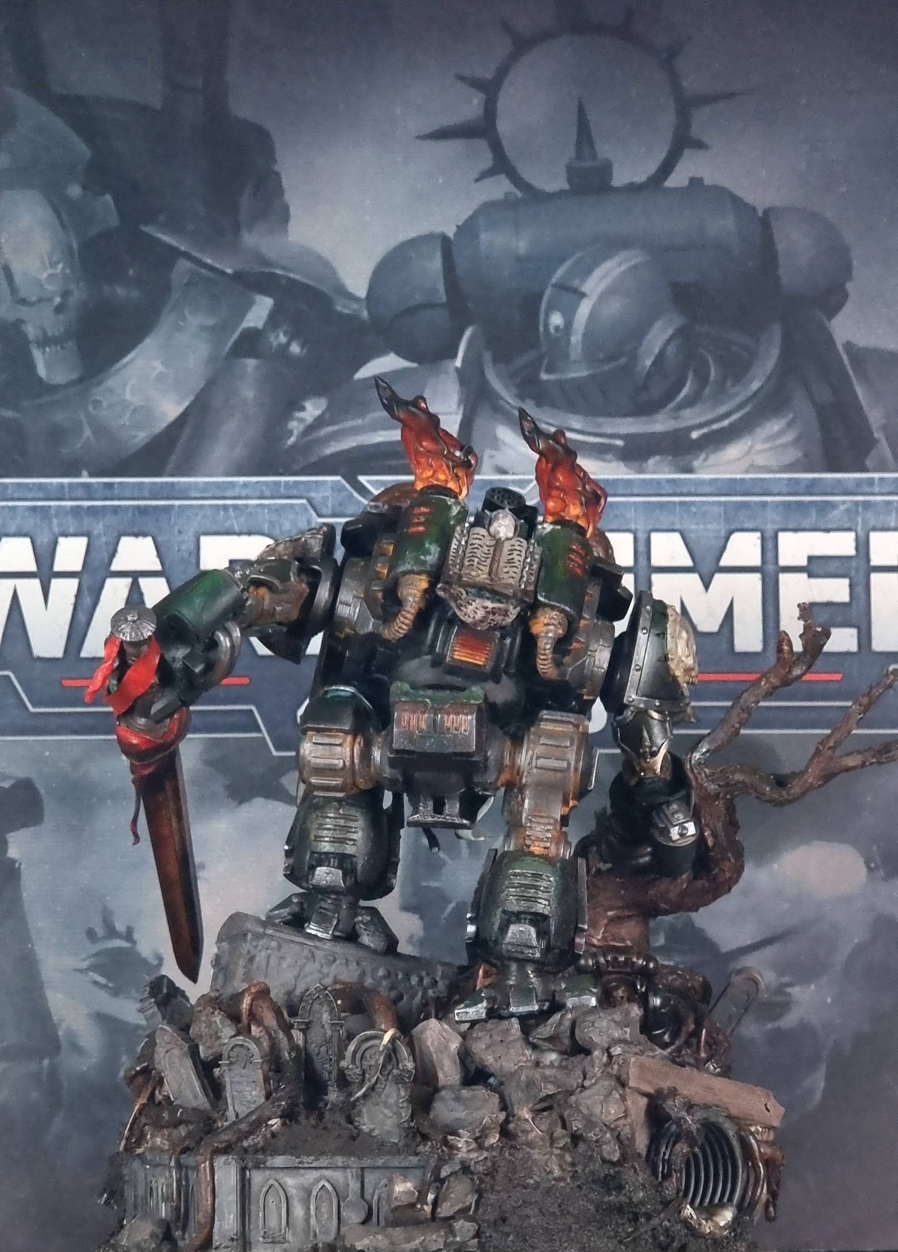

AncientBelion Posted November 21, 2025 Share Posted November 21, 2025 (edited) My first actual post here and with it my first mini I've painted. Ancient Belion of the Dark Angels chapter - stock Dreadnought with resin printed accessories (the shin and arm guards are downscaled Titan parts, sword is ripped from Elden Ring) and Miliput modelled details (the rough weld parts and the parchments and cloth). The rough texture on the mini is Miliput dilluted with IPA and then applied with a brush before priming. Lots more detail work to do on the mini and especially the base (which I've just started - it's missing mud, water pools and grass). From the start I'll say I've done a big mistake of assembling the mini and putting him on the base before painting. It was... well, a real pain to get to some parts (memo for the other minis). I'd love to hear your feedback, I really want to improve (first attempt at a mini after all). Also, have to step up my lighting game, the colors are a lot more saturated than on the images. This image is close to the actual saturation. Edited November 21, 2025 by AncientBelion Changed image hosting service Valkia the Bloody, Vairocanum, Firedrake Cordova and 5 others 4 4 Back to top Link to comment https://bolterandchainsword.com/topic/387152-dark-angels-dreadnought-ancient-belion-wip/ Share on other sites More sharing options...

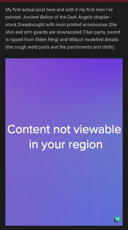

Captain Idaho Posted November 21, 2025 Share Posted November 21, 2025 Sorry to be the bearer of bad news but whatever hosting site you've used isn't showing up: Link to comment https://bolterandchainsword.com/topic/387152-dark-angels-dreadnought-ancient-belion-wip/#findComment-6143356 Share on other sites More sharing options...
AncientBelion Posted November 21, 2025 Author Share Posted November 21, 2025 28 minutes ago, Captain Idaho said: Sorry to be the bearer of bad news but whatever hosting site you've used isn't showing up: Thanks for the notice, changed the host from IMGUR to IMGBOX - hope it works now. Link to comment https://bolterandchainsword.com/topic/387152-dark-angels-dreadnought-ancient-belion-wip/#findComment-6143358 Share on other sites More sharing options...
Firedrake Cordova Posted November 21, 2025 Share Posted November 21, 2025 (edited) The base, flames, and rusty armour/angel wings are all great I don't suppose you'd mind sharing your rusty metal recipe? P.S. The images work now. You can also upload them to the Bolter and Chainsword's Gallery feature - you can see a tutorial for posting images in content and using the Gallery feature at: Edited November 21, 2025 by Firedrake Cordova AncientBelion 1 Back to top Link to comment https://bolterandchainsword.com/topic/387152-dark-angels-dreadnought-ancient-belion-wip/#findComment-6143361 Share on other sites More sharing options...
Captain Idaho Posted November 21, 2025 Share Posted November 21, 2025 Ah that does it. Very nice work, I must say. AncientBelion and Firedrake Cordova 1 1 Back to top Link to comment https://bolterandchainsword.com/topic/387152-dark-angels-dreadnought-ancient-belion-wip/#findComment-6143364 Share on other sites More sharing options...
W.A.Rorie Posted November 21, 2025 Share Posted November 21, 2025 Very nice AncientBelion and Firedrake Cordova 1 1 Back to top Link to comment https://bolterandchainsword.com/topic/387152-dark-angels-dreadnought-ancient-belion-wip/#findComment-6143365 Share on other sites More sharing options...
AncientBelion Posted November 21, 2025 Author Share Posted November 21, 2025 Thank you very much. I'll also give the gallery a try next time, so thanks for the notice. As for the rust - sure. Whole mini was primed with Vallejo mecha primer white, then a base coat of Rhinox hide. Afterwards, I applied a thin layer of AK crusted rust depost light and medium - first a general coat with medium, followed by small parts (recesses) with light. The metal looks all orangey and yellowish at this stage, with the Rhinox hide showing out at some parts. Once it was dry, I dry brushed it with some cheap Mars Brown acrylic paint (it was the only darker brown I had in comparison to Rhinox hide), then lightly dry brushed it with Rhinox hide (to get that variation in the browns). The last part was a slight dry brush with a silver vinyl color (the same one used for the scratches), which I also used for the exposed edges, applying it with a toothpick (I did a pass with a pencil for the edges at the very end, which of course is barely visible on these photographs, but it really gives that nice, worn metal shine). Firedrake Cordova 1 Back to top Link to comment https://bolterandchainsword.com/topic/387152-dark-angels-dreadnought-ancient-belion-wip/#findComment-6143369 Share on other sites More sharing options...
Firedrake Cordova Posted November 21, 2025 Share Posted November 21, 2025 Whilst I'm aware of the technique of using graphite to portray exposed metal on edges, it's not one I'd have thought of. Are you using a standard HB pencil, or is it a specific grade (2B, etc)? Link to comment https://bolterandchainsword.com/topic/387152-dark-angels-dreadnought-ancient-belion-wip/#findComment-6143421 Share on other sites More sharing options...
Solution AncientBelion Posted November 21, 2025 Author Solution Share Posted November 21, 2025 I used a standard HB pencil. While it doesn't really add much color to the edges, it makes them shine. So I'll keep using it for that effect, but certainly needs some silver paint beforehand. Tried it on the pauldrons directly, and besides streaks of reflections when I turn the model, there's no other sign. Firedrake Cordova 1 Back to top Link to comment https://bolterandchainsword.com/topic/387152-dark-angels-dreadnought-ancient-belion-wip/#findComment-6143432 Share on other sites More sharing options...
