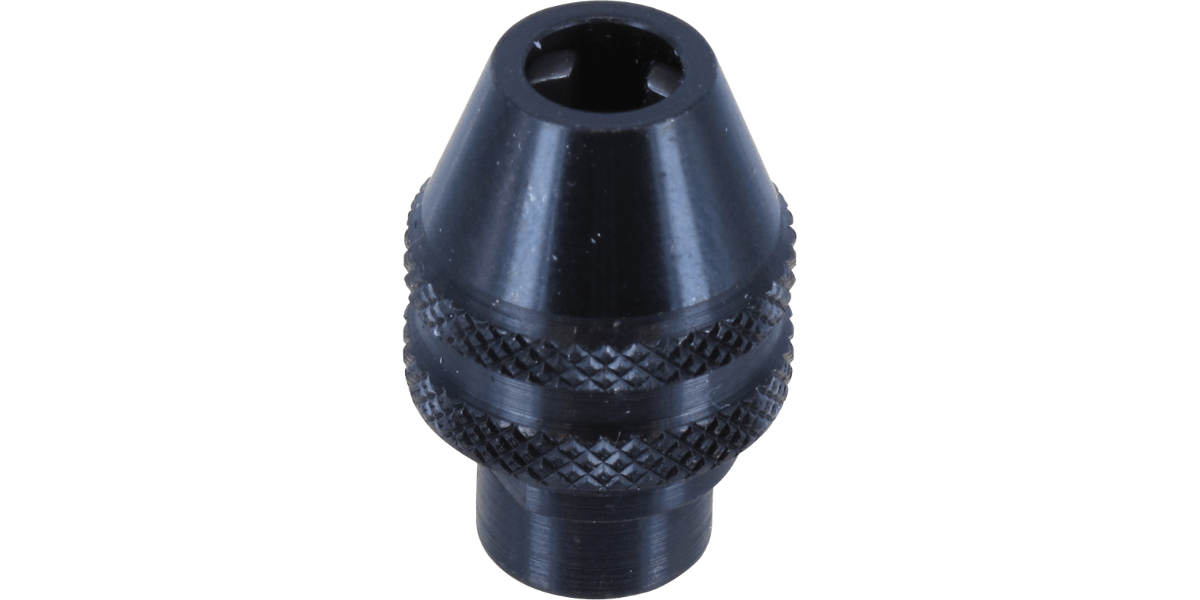

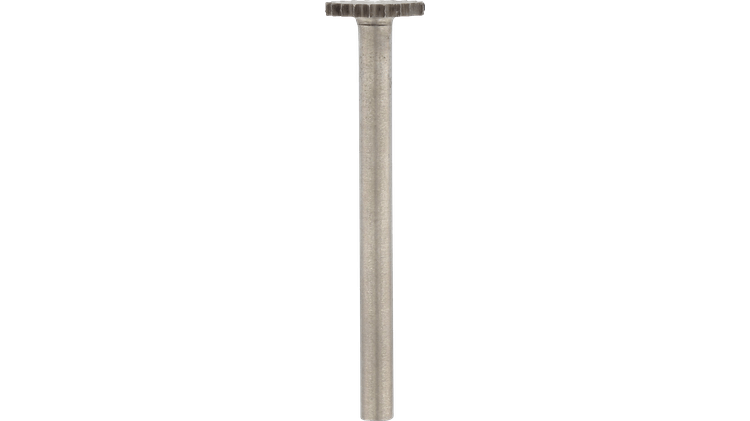

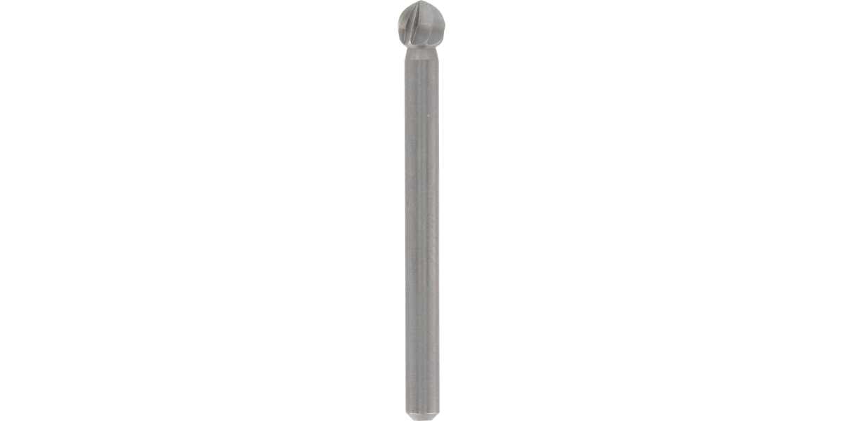

Bouargh Posted December 30, 2025 Share Posted December 30, 2025 (edited) Grinding tools on plastic are quite touchy as the material tend to melt. It is therefore important to carve slowly and let cool. Yet it is one of the most useful tool. The most useful accessories IMHO are: - chuck - this is the MOST important accessory as it allows you being independant from DERMEL for further items: indeed any size will fit whereas otherwise you are doomed to buy Dremel material. It is not that the diameters are made uncompatible, but most of time there are finishing issues and the fitting is not perfect going to get some loose issue. Which can be dandegrous if the accessory gets out of its place. - high speed cutter/carving - you will need different shapes and sizes if you want to go the sculptor way. Otherwise 2 as such may be enough. - drills (of course) - but was it needed to say it? You will need spares as, even in plastic, the smallest ones when used for pinning may easily break - Top of the Pop: any handle that allows gatting a better grip or more precision, allowing to take the tool as a pen for example. - The cherry on the cup cake (Pimp my Dremel's Edition): somehow a diamond disk for large size job. But this type of tool is hard to use properly and most of times do not worth the RoI Yet, be aware that if tagged "DremelTM" all these accessories will cost you an arm if bought on retail; you should aim at a boxed set including all as a special offer. If there is no such kit available, look for alt brand as 4 of these accessories above will probably coast you more than the main motorized tool... Edited December 30, 2025 by Bouargh tools added Trokair, Firedrake Cordova and Ironwulf 3 Back to top Link to comment https://bolterandchainsword.com/topic/387323-rotary-tool-recommendation/#findComment-6148883 Share on other sites More sharing options...
