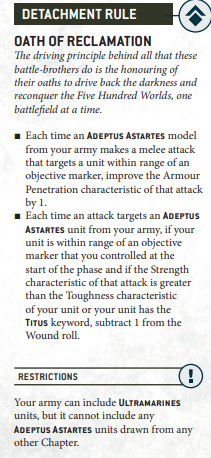

Tacitus Posted January 8 Share Posted January 8 Did a deep dive and some of the things that jump out at me: Bastion Task Force: The Detachment rule feels weak. Auspex feels like it will have the same up-time problems as Battleshocked. Assault Intercessors are going to love Blades of Valour. Eye of the Primarch on 10 Intercessors or HINTs will be very annoying. Codex Discipline is somewhat of a second OOM and probably should have just gone for a "Treat this target as your OOM Target until the end of the phase) like they've been doing elsehwere. Light of Vengeance being either/and/or is going to trip some people up and makes it pretty good. Shock Bombardment and Guided Disruption are fairly strong hits Pinned and Suppressed will be making a comeback in 11th. Angels Defiant could be a replacement for Armor of Contempt or a potential partner. Orbital Assault Force: The Detachment Rule is a double edged sword. You only get five turns, and putting more stuff into Reserve just means you get less stuff to play with on fewer turns, so when they DO come onto the board you have to make that Alpha Strike turn from each unit matter. Laurels of Thunder is kind of weak considering Terminator Captains have it all the time. Veterans of the Vanguard and Orbital Uplink Reliquary are both fairly common Captain rules. Suppresion Strafing: more Suppresed rule. Tactical Decapitation - likely to be the first thing nerfed out of all of these. Think: Land Raider Variants, Eradicator Squads, Vindicator Demolisher Cannons, Ballistus Dreads, Centurion Devastator Squads, Desolation Squads, and so on - Basically anything that can land 5+ Lascannon, Superkrak, etc shots with PRECISION. "Yeah I'm going to shoot at Abadon's squad with 6 Twin Linked Lascannon shots to reroll the to-wound, and basically 12 Krak Missiles. Oh and I get +1 to Hit and can assign them all to Abby. And its a strat, so you can do it all day as long as you have enough Giant Cannon and/or thousand points of light units. The only Characters that are safe are the ones who have some durable form of Lone Operative. Someone else would have to do the math, but I'm not 100% sure even The Silent King can withstand 6 Cent Devs using PRECISION to avoid the Menhir. Autosense Coordination seems to be a faily common end result (Pick LH or SH1) with different flavor requirements based on the Det. Reclamation Force: Det Rule: Power Fists and MC Power Swords galore. Additional -1AP to melee means AP-3 Fists, Hammers, and Swords. Seals of Reconquest - Very much want to put this on a lieutenant joining Sicarius leading Victrix Guard. but can't. Can do a generic Captain though. Avenging Avatar - Put it on a shelf until you see Battleshock in 11th - unless you REALLY want to lean into Battleshock with Reivers and such making a "funny" if not especially/directly powerful army. Scroll of Proclamation - downgraded Terminator Captain bespoke which will be nice piggybacked on the better Terminator Libby/Chaplain and especially a Terminator Ancient paired with Terminator Calgar. Liberatum is probably the best choice but only slightly ahead of SoP above. Crusading Conquerors is a nice Whoopsie button, but not much more than that. Furious Dedication + SoP Ancient, Plus Calgar and 10 other Terminators for the most mobile Terminator Death Star you've ever seen. Move 5, Advance D6, Shoot, Charge 2D6+2 Rerollable Ultramarian Destiny will be a big help if you do end up leaning into a lot of Bladeguard, Terminators, and some Victrix Link to comment https://bolterandchainsword.com/topic/387383-500-worlds-detachments-future-proofing-and-11th-edition/#findComment-6150575 Share on other sites More sharing options...

Tacitus Posted January 8 Share Posted January 8 (edited) 1 hour ago, jaxom said: I think you are; and if so, the Battleline enhancement in a non-Battleline Squad only benefits by giving access to the Angels Defiant strat. Hmm, actually forces one to really play Tag with auspex scan if bringing non-Battleline units.D It also gives you another unit to tag for Auspex Scans. you can use the Enhancement to give Battleline to a non-Battleline unit who can then use the Interlocking Tactics Det Rule Quote I'm not sure where the "and" comes in for LoV? And how would one partner AD with AoC when AoC isn't in the detachment? Covering all the bases in LoV. You can use if if you're A, and you can use if if you're B, and there's no restriction if you're A AND B. As for Partnering AD and AoC I'm guessing at furture 11th Edition stuff. Edit to Add: Also I would have thought the level of absolutely broken-ness that is the Tactical Decapitation would have been the bigger attention grabber. Edited January 8 by Tacitus Link to comment https://bolterandchainsword.com/topic/387383-500-worlds-detachments-future-proofing-and-11th-edition/#findComment-6150582 Share on other sites More sharing options...
Malakithe Posted January 8 Share Posted January 8 The auspex scan mechanic reads a bit like markerlighting. One unit tags and others benefit. Link to comment https://bolterandchainsword.com/topic/387383-500-worlds-detachments-future-proofing-and-11th-edition/#findComment-6150592 Share on other sites More sharing options...
