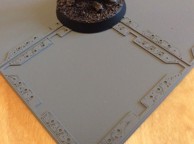

Dosjetka Posted October 22, 2016 Share Posted October 22, 2016 Damn, that looks pretty good. What's the surface detail/texture like? EDIT: Wouldn't be able to write properly to save my own life. Link to comment https://bolterandchainsword.com/topic/327145-3d-printed-terrain-zone-mortalis/#findComment-4541259 Share on other sites More sharing options...
Col.hertford Posted October 22, 2016 Author Share Posted October 22, 2016 Damn, that looks pretty good. How's the surface texture like? Well it has the usual straitions but it is no where as bad as they used to be. If I could print in ABS (which i won't in the house) I could smooth with painted on acetone. Ethyl Acetate works the same, but not so well, for the pla I use. Once I have a dedicated workspace, I may try it. Link to comment https://bolterandchainsword.com/topic/327145-3d-printed-terrain-zone-mortalis/#findComment-4541269 Share on other sites More sharing options...
Andvarr A Posted October 22, 2016 Share Posted October 22, 2016 Damn, that looks pretty good. How's the surface texture like?Well it has the usual straitions but it is no where as bad as they used to be. If I could print in ABS (which i won't in the house) I could smooth with painted on acetone. Ethyl Acetate works the same, but not so well, for the pla I use. Once I have a dedicated workspace, I may try it. Liquid greenstuff? That may help smooth out the thin gaps. How much was your machine, if you dont mind me asking Colonel? @dosjetka: you been on the amesac again? Link to comment https://bolterandchainsword.com/topic/327145-3d-printed-terrain-zone-mortalis/#findComment-4541289 Share on other sites More sharing options...

Col.hertford Posted October 23, 2016 Author Share Posted October 23, 2016 @ Andvarr A, it was from here http://www.prusa3d.com/ I did buy it pre Brexit so it was cheaper back then. @ subtle discord, cheers for the heads up. I've heard good things about smooth on. @ Magos Kasen, the big cost of 3D printing is the printer itself. I estimate a £17 spool will do around two one foot tiles. The big challenge is building he model to the strengths of the medium. @ Mechanist, will check it out. here's a few close ups of print examples. The floor tiles were printed as part of my initial calibrations, so the edges aren't representative of the printer capability. Internet points for anyone who guesses the orange item! Link to comment https://bolterandchainsword.com/topic/327145-3d-printed-terrain-zone-mortalis/#findComment-4541865 Share on other sites More sharing options...
Atia Posted October 23, 2016 Share Posted October 23, 2016 Do you have the original tiles? Because from that size comparison, it looks like yours are larger (and not as high) than the FW ones. That said it also looks far less warped lol Hidden Content Or maybe I'm just too tired atm haha. Anyways looks awesome ! Link to comment https://bolterandchainsword.com/topic/327145-3d-printed-terrain-zone-mortalis/#findComment-4542095 Share on other sites More sharing options...
Col.hertford Posted October 23, 2016 Author Share Posted October 23, 2016 @ Atia, yeah, the base depth is lame, it was printed purely to get a feel for the printer. The base is only 5mm deep. The new ones will be 12mm which is the average height I've seen quoted. The current height of the walls is 50mm so are a little shorter than the official tiles and will get a rework. The floor tiles are 50 x 50 mm. They should be the same size as the FW ones based on the measurements I've seen on line, it may be the lack of the grates on two sides causing an optical illusion. I've ordered a single tile, and a set of small doors to assist me on this project, I want this to be good. Link to comment https://bolterandchainsword.com/topic/327145-3d-printed-terrain-zone-mortalis/#findComment-4542157 Share on other sites More sharing options...
