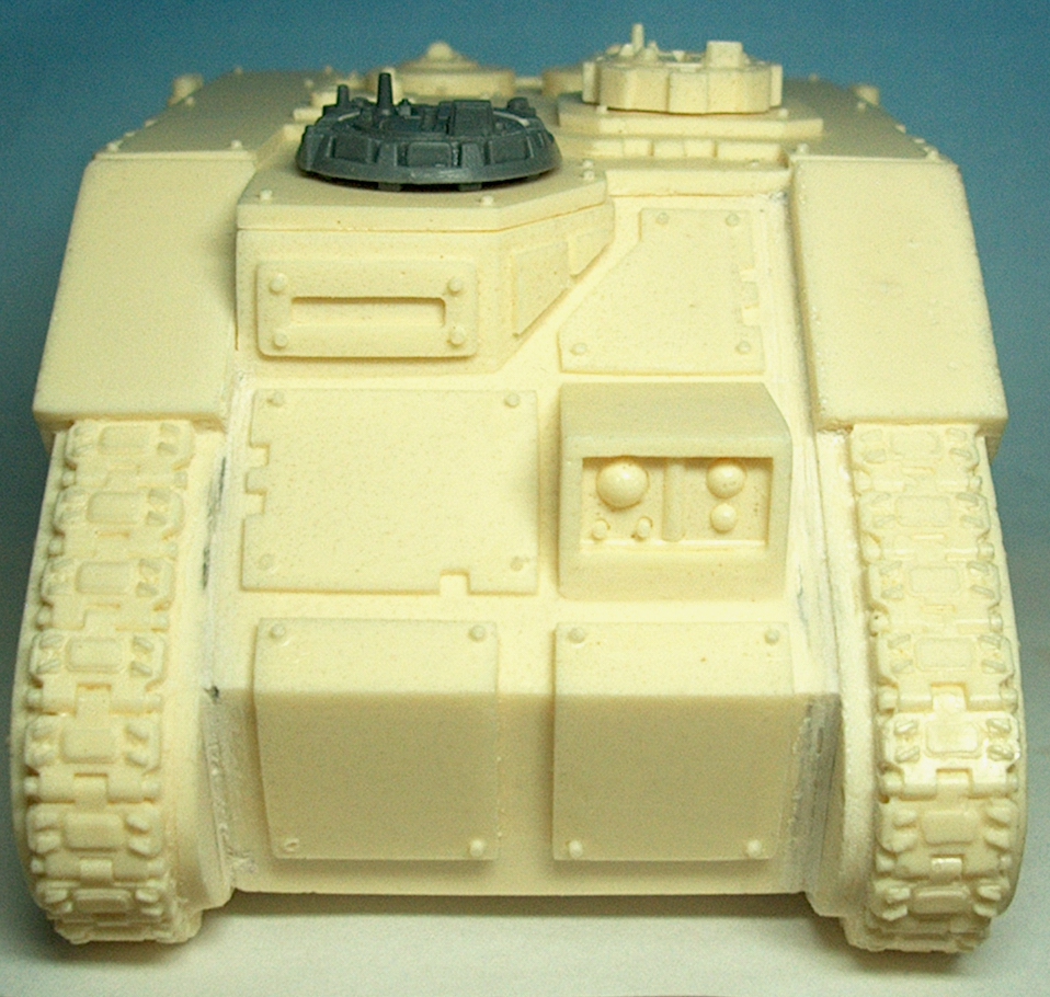

araekyus Posted August 2, 2012 Author Share Posted August 2, 2012 I humbly present the 98% complete first cast of the 'Clouseau' MK IIIa Pattern Rhino :D Presented here with a standard GW crew hatch. The engine stacks are blu tacced on for the now as i do need to do some more sanding and trim work on them. The inner rear track sides will have detail added in the form of another cast plate that is in the prototyping phase on my desk at the moment. Also the front inner track side near the nose armour will get some detail parts as well. Just trying to decide what to put there. All this was done with one piece block molds, slow set resin which was painted into the detail first then slow poured in to at the lowest point in the mold, excess scraped down with a bondo scraper, then left to cure on my bookshelf. No vacuum done. (yet;) There are still faults in this cast. Missing rivets, the odd pocket tidied up with contour putty, weird over flow, gaps (ohhh the gaps drove me insane for days) and what seems like some kind of brown dust particles in some areas, although very tiny. But it is a learning curve so I will try to be more diligent in solving those issues with my next batches. I am quietly pleased with how this turned out, and I hope you all enjoy it:) C&C most welcome as always. Side Note: A few posts back, I mentioned that I would try to create a detailed breakdown of how the prototype was put together. Sadly, in order for me to do this I would have to utterly dismantle it and the pieces would most likely get damaged by doing so. Many apologies for this. Next project, I'll try to create a better break down as during progress (and stop using my damn iphone for pics haha) Link to comment https://bolterandchainsword.com/topic/250018-clouseau-rhino-project/page/2/#findComment-3139099 Share on other sites More sharing options...
Nym468 Posted August 2, 2012 Share Posted August 2, 2012 Looks great, can we get a comparison shot? Link to comment https://bolterandchainsword.com/topic/250018-clouseau-rhino-project/page/2/#findComment-3139468 Share on other sites More sharing options...
araekyus Posted August 2, 2012 Author Share Posted August 2, 2012 Looks great, can we get a comparison shot? Sure:) Here are a quick set of side and front views with a normal plastic rhino. Link to comment https://bolterandchainsword.com/topic/250018-clouseau-rhino-project/page/2/#findComment-3139483 Share on other sites More sharing options...
