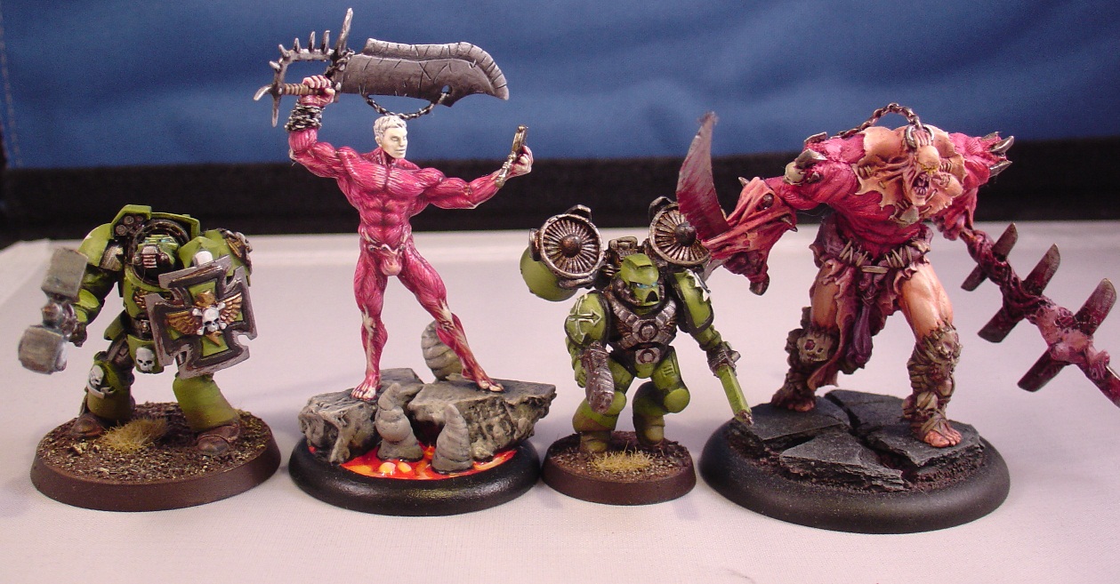

Durus Posted July 19, 2014 Share Posted July 19, 2014 Do you know Helldorado? Their Demons range has some miniatures that I think would probably make great bosses for your =][= 28 games, or even nice count as models for your 40k Slaanesh armies. Damned ones of Pride. Perfect fit for Slaanesh and incidentially also skinned, so sounds like it is exactly what you were looking for to me. Could be a pretty good BBEG for your campaign. Just swap that ridiculous sword for an Eviscerator or something like that. Great Damned One of Wrath. Kind of goes into the same direction, just with the focus on excess rather than 'perfection'. Would be a nice choice for a mini boss, or The Dragon. Here's a size comparison for the two. And because she also fits the theme of Slaanesh and skinning, The Succubus. Helldorado has some other minis that might be interesting. Aside from that I think you can probably get away with just painting the muscles onto a miniature, provided the body you are using is cut enough. With miniature like this and this painting the strands on and adding some good 'wet' highlights, with sharp contrast like here should give you the desired effect. Link to comment https://bolterandchainsword.com/topic/293929-how-to-paint-a-skinless-chap-or-chapette-help-needed/#findComment-3749167 Share on other sites More sharing options...
