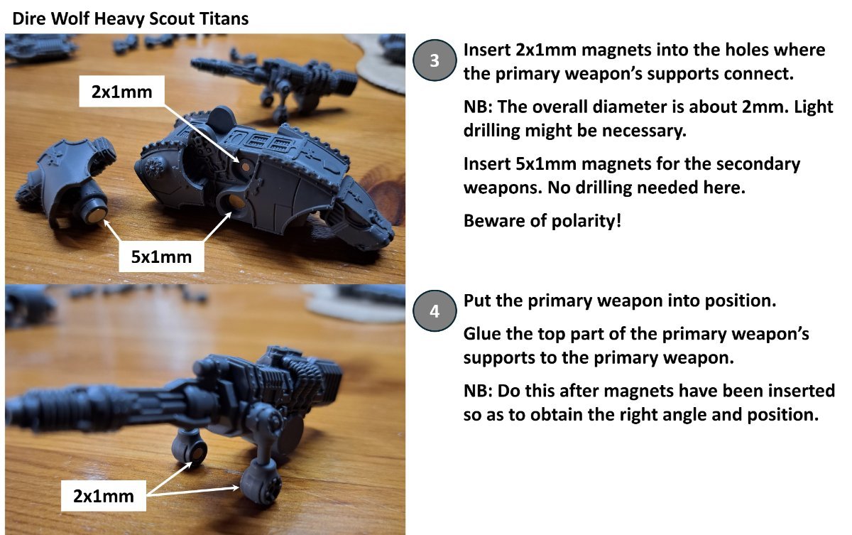

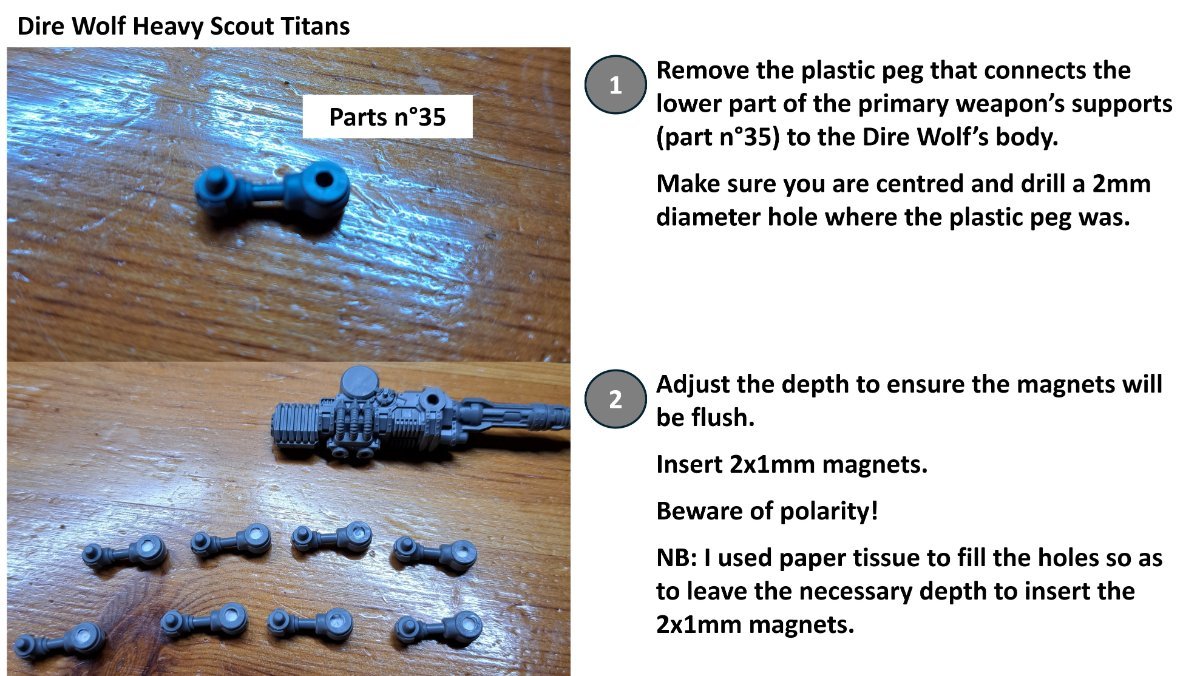

Mendi Warrior Posted April 29 Author Share Posted April 29 I eventually completed building my Dire Wolf Heavy Scout Titans. As usual, due to the multiple weapons' options, I used magnets. As customary, my rule for magnets is that those into the body attract those into the arms/weapons. I always use a model already built with magnets to check and ensure polarities are aligned. The secondary weapons, the Ardex mega-bolters, have been designed for using 5x1mm magnets. Straightforward built, you just need to ensure polarities are correctly aligned. Two of them go into the body, two into the weapons' mounts, 4 magnets per titan, so 8 5x1mm magnets are needed for the kit. Primary weapons, on the contrary, were not designed for using magnets. However, this is rather easy to do. The best is to use 2x1mm magnets. As you have 2 titans, 3 primary weapons per titan, 2 supports per weapon, you would need a total of 16 2x1mm magnets. The Conversion Beam Dissipator, Volcano Cannon and Neutron Laser are all connected to the titan's body through a pair of supports (see step 12B in the instructions). Each support (part 35) has pegs which go into holes in the weapon's body and in the titan's body. You get enough supports for each of the primary weapon available in the kit. The holes in the titan's body have an overall diameter of about 2mm, they can easily fit a 2x1mm magnet, light drilling might be necessary. I don't remember as I did this step a long time ago. Inserting magnets there means that you'll have to insert magnets into the lower part of each support. You'll need to remove the plastic peg and drill a 2mm diameter hole, centred where the peg was. If you drill a bit too deep, you can fill the hole so as to adjust the depth so that the magnets are flush. I usually use paper tissue and super glue for that. I gauge the necessary depth with a marked 2mm diameter toothpick. As usual, beware of polarity when inserting the magnets. Once this is done, you can glue each support to the primary weapon. It is best done after all magnets have been inserted and with the weapon in position so that the supports have the right angle and position. An alternative would be to insert the magnets into the primary weapons' bodies and into the upper parts of the supports. That would allow you to end up with spare supports as only one pair of those would be needed per titan. The number of 2x1mm magnets woud remain at 16 in total. My choice for the former option was driven by the idea that a slight deviation from the centre when drilling into the lower part of each support would be less noticeable than a slight deviation when drilling into the upper part, and also by my wish to have complete weapons with supports should I wish to use them on fortifications. In the end, it is mostly a question of preference. A couple pictures with annotations Interrogator Stobz, Spazmolytic, Captain Idaho and 1 other 4 Back to top Link to comment https://bolterandchainsword.com/topic/381884-mendi-warriors-legions-imperialis-project-log/#findComment-6168618 Share on other sites More sharing options...
