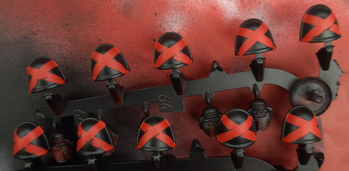

Karhedron Posted May 3 Author Share Posted May 3 I gave it a go and the results were not bad. A little bit of bleed where the tapes crossed (even though I sprayed red before black) but I can tidy that up with a brush I think. 2mm seems pretty decent thickness. It looks bold without being too wide. They also do 1.5mm width if you want something slightly finer. The crosses are not perfectly regular as lining up the tapes exactly is really hard but I think DC don't matter too much. Firedrake Cordova and Grotsmasha 2 Back to top Link to comment https://bolterandchainsword.com/topic/387858-how-to-paint-crosses-on-death-company/#findComment-6169362 Share on other sites More sharing options...
sitnam Posted May 4 Share Posted May 4 13 hours ago, Karhedron said: I gave it a go and the results were not bad. A little bit of bleed where the tapes crossed (even though I sprayed red before black) but I can tidy that up with a brush I think. 2mm seems pretty decent thickness. It looks bold without being too wide. They also do 1.5mm width if you want something slightly finer. The crosses are not perfectly regular as lining up the tapes exactly is really hard but I think DC don't matter too much. I think the bleed actually looks decent, as it looks like battle damage and wear. Whether you want wear or not is totally up to you, of course Karhedron 1 Back to top Link to comment https://bolterandchainsword.com/topic/387858-how-to-paint-crosses-on-death-company/#findComment-6169491 Share on other sites More sharing options...
Grotsmasha Posted May 4 Share Posted May 4 45 minutes ago, sitnam said: I think the bleed actually looks decent, as it looks like battle damage and wear. Whether you want wear or not is totally up to you, of course Agreed, it damage suits your paint style, highlighting the bleed cold look really good Karhedron 1 Back to top Link to comment https://bolterandchainsword.com/topic/387858-how-to-paint-crosses-on-death-company/#findComment-6169496 Share on other sites More sharing options...
