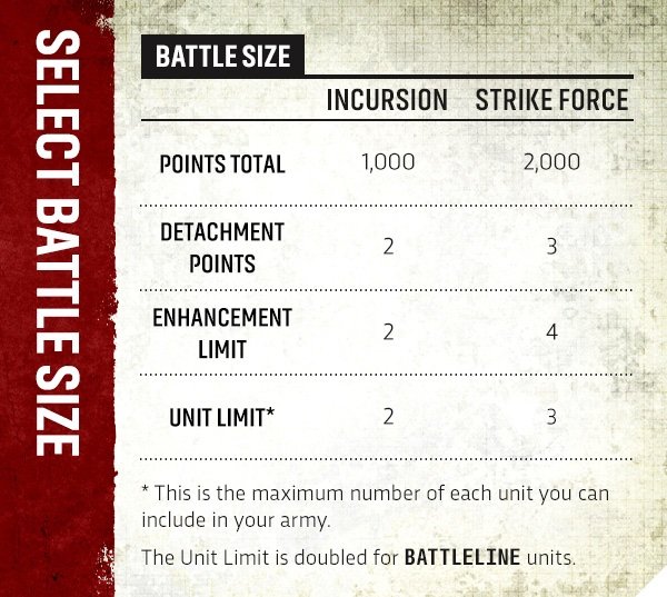

Valkyrion Posted June 12 Share Posted June 12 I didn't play a single game or buy a single codex of 10th and only had the Leviathan box and its contents, so I missed the nuance of this reset, but I'm turning back to 40k for 11th and I want to do it properly from the beginning. No skirting around rules I don't like or find unintuitive, no conflating lore with rules, no shaking my head ruefully at enemy super heavies etc. I want to be part of the ship, part of the crew. So, I have a few questions/statements that I'd like clarifying if I may; List building: There's no such thing as elites or fast attack or heavy support - there's Leader, Support, Battleline and then everything else, right? There's a limit of 3 of any given datasheet - is there anything stopping me from fielding an army full of leaders, or vehicles, or just battleline? I presume I need a Leader and a Battleline, but one never knows. Detachments and Dispositions: How do I know which disposition is unlocked by a detachment? How do I know how many Enhancements or Upgrades I can take, and are they free in terms of list building points? (e.g, is it a 50 point charge on top of the 2 detachment point cost or something?) Are detachments and enhancements designed to be tailored, or is that frowned upon? For instance, am I free to choose which enhancement at the start of the game, or is it declared upon list creation? No doubt there'll be more, but once I understand these I think my 40k muscle memory will kick in and the wargame switches in my brain will align. 2 Back to top Link to comment https://bolterandchainsword.com/topic/388076-making-an-effort-for-11th-after-skipping-10th/ Share on other sites More sharing options...
Tawnis Posted June 12 Share Posted June 12 List Building: - Yes, that's essentially correct. You only need one character in your army and can take anything else. If that datasheet is marked unique (usually just named characters) you can only take 1. 3 for most units. 6 for Battleline In a 2k game. (IIRC correctly they officially said 2/4 respectively for 1k game, but I don't recall where I read that off the top of my head.) - You can make an army of all tanks so long as at least 1 is a character. You don't need Battleline like you used to need Troops choices. D&D XD: - Each Detachment will have their disposition listed next to them. - 3 Per army was last edition, I don't recall if they've 100% clarified it for 11th, but the assumption is it's still 3 for the army overall regardless of number of detachments taken. - It is designed for enhancements to be taken on list creation and should be submitted with your army list. Fell free to hit me up if you have any more questions. Always glad to help out new or returning players. 1 1 Back to top Link to comment https://bolterandchainsword.com/topic/388076-making-an-effort-for-11th-after-skipping-10th/#findComment-6175218 Share on other sites More sharing options...

W.A.Rorie Posted June 13 Share Posted June 13 So at 1k the max unit is 2 unless battleline, then it is double so 4 at 2k it becomes units is 3 unless battleline, then it is double so 6 from this WarComm Article 2 1 Back to top Link to comment https://bolterandchainsword.com/topic/388076-making-an-effort-for-11th-after-skipping-10th/#findComment-6175332 Share on other sites More sharing options...

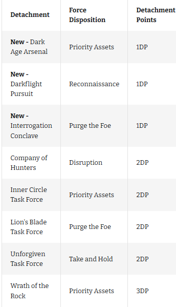

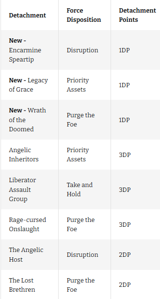

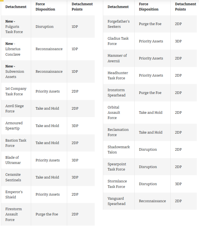

Valkyrion Posted June 16 Author Share Posted June 16 Going back to the detachments; If I pick 2 (or 3) detachments, do I gain everything? The detachment rule, availability of enhancements and all stratagems? Using Chaos Knights as that's the PDF I have open; If I picked all 3 1DP detachments, my Tyrant would have +1 to hit battleshocked units, my War Dogs would have +6" spotting range and I could take a unit of cultists. I could then pick one enhancement from each, and gain access to all 9 stratagems. Link to comment https://bolterandchainsword.com/topic/388076-making-an-effort-for-11th-after-skipping-10th/#findComment-6175779 Share on other sites More sharing options...
Karhedron Posted June 16 Share Posted June 16 Yes, that's right. If you pick all 3 1-point Detachments, you would get access to everything they contain. 1 Back to top Link to comment https://bolterandchainsword.com/topic/388076-making-an-effort-for-11th-after-skipping-10th/#findComment-6175793 Share on other sites More sharing options...
Valkyrion Posted June 16 Author Share Posted June 16 (edited) Okay, so I think I'm seeing a pattern. 1DP gives a benefit to a unit type - could be Psyker, could be Walker, could be Character 2DP gives a benefit to the army with an exception - e.g all Infantry but not Vehicles, or all vehicles but not infantry 3DP gives a benefit to the whole army. Is that basically it? Edited June 16 by Valkyrion Link to comment https://bolterandchainsword.com/topic/388076-making-an-effort-for-11th-after-skipping-10th/#findComment-6175798 Share on other sites More sharing options...
Karhedron Posted June 16 Share Posted June 16 24 minutes ago, Valkyrion said: Okay, so I think I'm seeing a pattern. 1DP gives a benefit to a unit type - could be Psyker, could be Walker, could be Character 2DP gives a benefit to the army with an exception - e.g all Infantry but not Vehicles, or all vehicles but not infantry 3DP gives a benefit to the whole army. Is that basically it? Close but not entirely Sage of the Beastslayer (Space Wolves) gives the entire army Lethal Hits vs Monsters and Vehicles (with the ability to have it vs everything) but is only 2DPs. I think GW have done it based on how successful the Detachments were in competitive play over the last year or so. 1 1 Back to top Link to comment https://bolterandchainsword.com/topic/388076-making-an-effort-for-11th-after-skipping-10th/#findComment-6175800 Share on other sites More sharing options...
Valkyrion Posted June 16 Author Share Posted June 16 Okay, last (for now) question - you linked me to WarCom showing DP values, so are these DP values listed in the codexes or something? Surely it's not solely a vague link on WarCom that tells us DP values? The only 10th ed codex I have is Tyranids, and I can't recall seeing anything in their detachments that tells me how many points they are, but I could easily be wrong. Link to comment https://bolterandchainsword.com/topic/388076-making-an-effort-for-11th-after-skipping-10th/#findComment-6175815 Share on other sites More sharing options...
Karhedron Posted June 16 Share Posted June 16 Not in the codices yet since they were printed before the idea existed. Most likely they will be listed in the MFM alongside points values for units. I believe a new one is due to be released tomorrow. 1 Back to top Link to comment https://bolterandchainsword.com/topic/388076-making-an-effort-for-11th-after-skipping-10th/#findComment-6175825 Share on other sites More sharing options...
