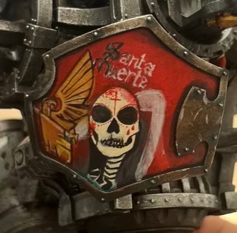

Blissful Brushes Posted June 30 Share Posted June 30 I’m using W&N size 1 from Amazon, it might be watercolour but I cannae remember. I got 3 for £20, 1 is a bit crap and has been relegated to basecoats but the other one (#3 still unused) is what I’m using for my fine detail work - which includes free hand (don’t judge the teeth, she needs dental work, but that’s a tomorrow problem) Firedrake Cordova 1 Back to top Link to comment https://bolterandchainsword.com/topic/388148-winsor-and-newton-size-one-brush/#findComment-6178139 Share on other sites More sharing options...
Rowland Posted July 1 Author Share Posted July 1 11 hours ago, Blissful Brushes said: I’m using W&N size 1 from Amazon, it might be watercolour but I cannae remember. I got 3 for £20, 1 is a bit crap and has been relegated to basecoats but the other one (#3 still unused) is what I’m using for my fine detail work - which includes free hand (don’t judge the teeth, she needs dental work, but that’s a tomorrow problem) Blimey, if only I was as steady of hand Good English teeth as the Americans say. Link to comment https://bolterandchainsword.com/topic/388148-winsor-and-newton-size-one-brush/#findComment-6178197 Share on other sites More sharing options...
