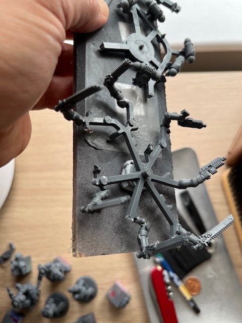

Rowland Posted July 16 Share Posted July 16 @Dr. Clock I thought I would move the discussion here… Re mounting parts on “Sprue Spiders” I’m having a devil of a job making the bits stick. I’m using Loctite super glue but it doesn’t want to set quickly so I have to hold each part steady for what seems like ages it’s become a right old faff. To anyone else…how do you mount your arms, pauldrons, etc for painting?… Firedrake Cordova 1 Back to top Link to comment https://bolterandchainsword.com/topic/388252-mounting-parts-for-painting/ Share on other sites More sharing options...

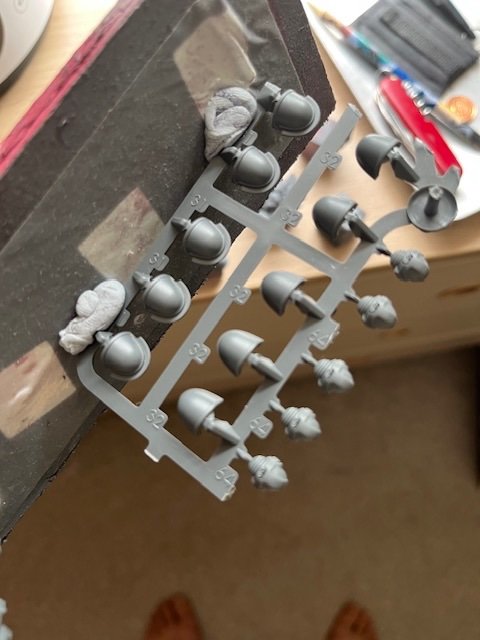

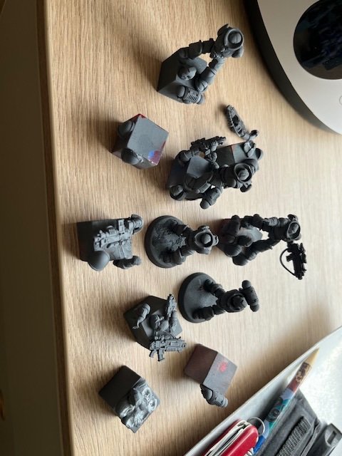

Rowland Posted July 16 Author Share Posted July 16 (edited) Well, this was my original method…blu tack on wooden blocks. Now I prefer Dr Clocks method…. And when life gives you lemons… I looked at the Citadel sub assembly holders…I bought the smaller base holder thing and never got on with it. Sometimes a model would pop out and swapping models was a faff. I bought some cheap glass bottles with screw top metal lids which feel lovely, especially with some weight added and I have about 24. So a magnet on the models base and or bluetac and they’re good to go. Those sub assembly holders are a neat solution if you go all in with the system but doing it cheaper is satisfying. Unless you run out of Christmas present ideas. Edited July 16 by Rowland Firedrake Cordova and Dr. Clock 1 1 Back to top Link to comment https://bolterandchainsword.com/topic/388252-mounting-parts-for-painting/#findComment-6179712 Share on other sites More sharing options...
