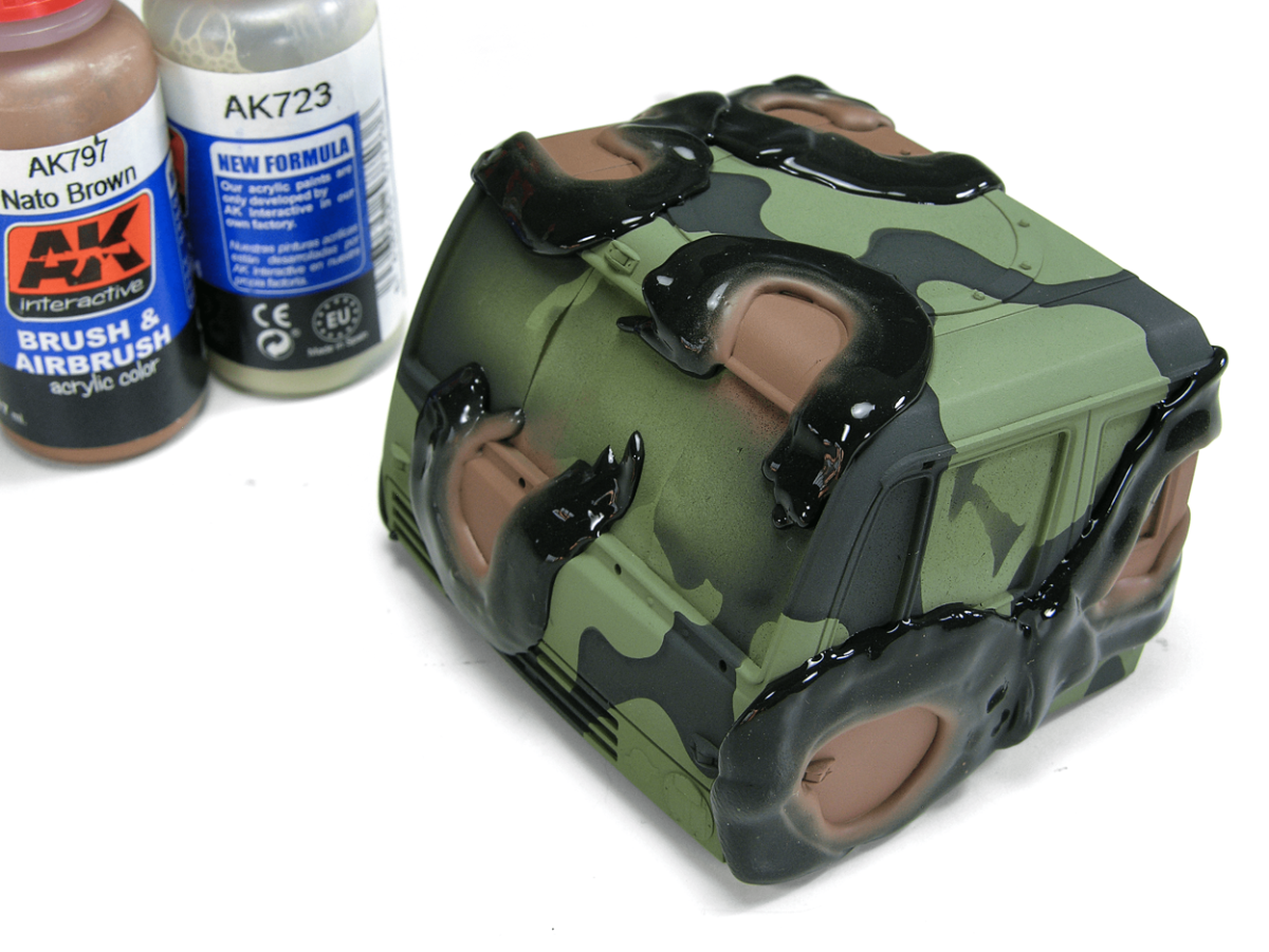

Adeptekon Posted September 4 Author Share Posted September 4 Thanks, what do you guys use to mask off? greenstuff? or tape? Link to comment https://bolterandchainsword.com/topic/388465-multi-priming/#findComment-6185486 Share on other sites More sharing options...
WBRBloom Posted September 4 Share Posted September 4 The only masking I've done until now, was on a Warhound Titan shin guard, to imitate Legio Mortis colour stripes, and I used Tamiya masking tape. Depending what you're looking to paint/mask, you might even use painter's tape, which would cost waaaay less. But you'll need to cut it to size and shape. I've used blue tack before, but you need to be extra careful, as it can rip off other stuff when removing it. If you're in the US, a cheap solution is also silly putty, which has essentially the same consistency as masking goo here in the UK/EU. If you are in the UK/EU then you can try masking putty/goo, which is basically a reusable putty that does not stick that much, and you can use it to cover big areas (such as knight shoulder parts for example) and shape it any way you like: Hobby Heaven Elastic Masking Putty – Professional Reusable Airbrush Masking Compound for Scale Modeling, 80g, No Residue, Precise Camouflage & Detail Protection : Amazon.co.uk: Home & Kitchen 1 Back to top Link to comment https://bolterandchainsword.com/topic/388465-multi-priming/#findComment-6185503 Share on other sites More sharing options...
