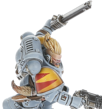

Karhedron Posted September 12 Share Posted September 12 Does anyone have any good advice for painting the pack markings on Space Wolves should pads? I will shortly be doing a large number of Grey Hunters and Blood Claws and I would really like to try an replicate the "dag" markings. In the past I have cheated with just a pack transfer on the right shoulder pad. The problem is that I cannot freehand straight lines. At all! Not on a flat surface and certainly not on a curved surface like a pauldron. So any tips, tricks suggestions or transfers I can use to get the effect shown below without having to paint straight lines by hand. Link to comment https://bolterandchainsword.com/topic/388519-advice-on-space-wolf-shoulder-pads/ Share on other sites More sharing options...
Lysimachus Posted September 12 Share Posted September 12 (edited) Maybe one option would be to paint (or even spray?) the whole pad in the lighter colour, then use masking tape to create the dag shapes? Then paint/spray all over again with the darker colour, let it dry, peel off the tape... you should end up with reasonably sharp edges? Edited September 12 by Lysimachus 1 1 Back to top Link to comment https://bolterandchainsword.com/topic/388519-advice-on-space-wolf-shoulder-pads/#findComment-6186497 Share on other sites More sharing options...
Karhedron Posted September 12 Author Share Posted September 12 Masking tape sounds promising actually. I did the crosses on my Death Company shoulder pads that way. The only tricky bit will be getting the size and shape consistent from model to model. Link to comment https://bolterandchainsword.com/topic/388519-advice-on-space-wolf-shoulder-pads/#findComment-6186528 Share on other sites More sharing options...
Solution Grotsmasha Posted September 13 Solution Share Posted September 13 (edited) Use a wider tape, and measure out a length on an easily removable surface, like a Tupperware lid. Then measure 6mm increments* along one edge, start the second edge @ 3mm, then continue withe the 6mm spacing. Then all you need to do is cut diagonally from mark to mark, this will get you many same size days. To place them, so the centre one first, pointy end first, this will leave the overhang to grip for easy removal. The best way to prevent bleed through is to paint the underneath colour over the tape too, as this will bleed, then the second, the intended colour, shouldn't. *6mm is a guess, it'll maybe be less. Edited September 13 by Grotsmasha 1 Back to top Link to comment https://bolterandchainsword.com/topic/388519-advice-on-space-wolf-shoulder-pads/#findComment-6186570 Share on other sites More sharing options...
