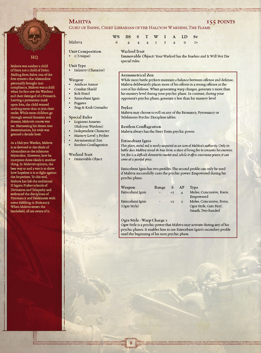

simison Posted April 12, 2015 Author Share Posted April 12, 2015 Okay, I put this page in its own post because it needs some background info. The program Grifftofer used was creating a blank page just due to how the content was laid out. It obviously looked weird and awkward to be going through the Appendix and find this random blank page, so he created an unique unit called the 'Old Souls' to fill it. I liked the idea and since the Emperor's Children have three unique units, I thought it fit. (Especially because the Prefects act more like a vehicle upgrade than a proper unique unit.) So, here's the debut of the Blitzers! Link to comment https://bolterandchainsword.com/topic/291742-the-renegade-legion/page/22/#findComment-4005845 Share on other sites More sharing options...
simison Posted April 12, 2015 Author Share Posted April 12, 2015 And there you have it! The Appendix of the Halcyon Wardens. At least, until I can afford to get some more appropriate art, but that's aways down the road. So, enjoy! Link to comment https://bolterandchainsword.com/topic/291742-the-renegade-legion/page/22/#findComment-4005852 Share on other sites More sharing options...

Tychii Posted April 13, 2015 Share Posted April 13, 2015 This looks great to, Pricing wise some things seem a bit off, but the best thing to do would be to get a couple of games in and see how they play out. pricing* Blitzers are a command squad with -5point power weapons, a free 6+ invul, and a free volkite serpenta The caryana detachement seems a bit cheap, and they should be equiped with power armour, as consuls are, and also I wouldn't allow them to take additional levels as that puts them as super discounted consuls. I would change Veterans of maelstorm to +1T. Rerolls on 2+, 3++ makes them a bit much Mahtva* is a basically an upgraded 3rd level psycher consul with unique wargeer, and all his special rules for free Ivan Ruel- I would just lower his WS as he is currently on par with sigismund and sevatar, the two biggest badasses in the warhammer universe minus the primarchs. Alexandros* level 4 psycher should be reserved for magnus, as logar transfigured is still only lvl 3, and 7 Initiative should really be reserved for the beatstick primarchs, as you currently are just as quick as Konrad and strike before all the other primarchs in combat. But, overall I would test them out and see what other people say. Link to comment https://bolterandchainsword.com/topic/291742-the-renegade-legion/page/22/#findComment-4006344 Share on other sites More sharing options...

Grifftofer Posted April 14, 2015 Share Posted April 14, 2015 Hi guys. I'm the aforementioned Grifftofer from over on the heresy30k forums. I'm a long-time lurker here, but thought I would actually sign up and try to provide some insight into my reasoning behind the Blitzers' pricing. I have been involved in discussions around the other units, but the Blitzers are somewhat more of my brainchild so I'll just cover them for now. This looks great to, Pricing wise some things seem a bit off, but the best thing to do would be to get a couple of games in and see how they play out. pricing* Blitzers are a command squad with -5point power weapons, a free 6+ invul, and a free volkite serpenta Firstly comments like these are really helpful. It forced me to go back and re-evaluate my thoughts from when I came up with the idea and check that I hadn't done something stupid. First off I will say that I didn't base them entirely off the Command Squad They used a combination of the Command Squad, Palatine Blades squad and Templar Bretheren. To me these three units were the closest to the themes I was aiming for. I also consider that the Jump Packs option for the Command Squad is overcosted, as indeed Jump Packs in general seem to be in 30k. +15 points per model is a +75% points increase per model, for what is a model with one wound that seems excessive. I therefore used the Palatine Blades points cost for Jump Packs, it's still a hefty points increase but not at the same level as the Command Squad's. Adding in the power weapon at +10 points is then the same cost as the Command Squad. Next is that the unit does not come with a 6+ invulnerable as standard. The Protectiva Solus is an upgrade that is purchased for the unit at a cost of +45 points. To me it fit with the 30k emphasis on things being better value as you increase squad size. Initially you are paying +15! points per model for a 6++, but that drops down as you get more guys to more reasonable values. Now to me that means that we have a model worth roughly 45 points. 20 (from command squad) + 10 (power weapon) + 10 (Jump Pack) + 5 (Volkite Serpenta). This would give the unit a 135 point cost for 3. The Age of Darkness tax for basic squads seems to run at around +5-10 points per model. Admittedly I was conservative with only adding 15 points, but I then had to compare them to the other models that cost around the same. Phoenix Terminators ~+2 points/model Deathshroud ~-5 points/model Firedrakes ~+5 points/model Lernaeans ~-5 points/model Now to me those units all compare relatively favourably to the Blitzers. Either they have more wounds, or the ability to strike in I order with AP2, or stubborn. Sure the Blitzers are quicker, but they are also less resilient (no invulnerable, no multiple wounds like 2 of the above). They are able to move quickly without having to pay for a transport, but they will be vulnerable to enemy fire whilst doing so and they are less resilient to that firepower anyway. Another small thing is that they also derive effectively no advantage from their Legiones Astartes: Halcyon Wardens special rule, beyond the always regroup at full Ld, as they are completely unable to take any kind of shield device. This was an intentional design decision, but it still needs to be taken into account. Anyway. I'm glad you guys seem to like how it looks. I've had great fun putting this together and playing around with it. If you have any suggestions as to how to make it look better/more like the Forgeworld books please tell me. I would appreciate it and I'm sure Simison would too. Link to comment https://bolterandchainsword.com/topic/291742-the-renegade-legion/page/22/#findComment-4007752 Share on other sites More sharing options...

simison Posted April 14, 2015 Author Share Posted April 14, 2015 Ha ha, I think you're getting popular Grifft. Anyway. I'm glad you guys seem to like how it looks. I've had great fun putting this together and playing around with it. If you have any suggestions as to how to make it look better/more like the Forgeworld books please tell me. I would appreciate it and I'm sure Simison would too. I second this. This looks great to, Pricing wise some things seem a bit off, but the best thing to do would be to get a couple of games in and see how they play out. The caryana detachement seems a bit cheap, and they should be equipped with power armour, as consuls are, and also I wouldn't allow them to take additional levels as that puts them as super discounted consuls. The price is in contention, along with the artificer armor. I've play-tested them once and aiming for another two games before I decide my mind. This looks great to, Pricing wise some things seem a bit off, but the best thing to do would be to get a couple of games in and see how they play out. I would change Veterans of maelstorm to +1T. Rerolls on 2+, 3++ makes them a bit much Veterans did use to give +1T, but after a while I noticed that S/T ratings don't really change within a species. (IE, space marines are S/T - 4, guardsmen are 3's, etc.) So, I changed it to fit the overall meta, while giving them the reroll reflects how skilled they are with their tool of war. I'll comment on the rest later. I have to prep for an interview right now. Link to comment https://bolterandchainsword.com/topic/291742-the-renegade-legion/page/22/#findComment-4007921 Share on other sites More sharing options...

Tychii Posted April 15, 2015 Share Posted April 15, 2015 The points on the blitzers seem quite fair. The jump packs are overcosted and in practice I'm sure they come out just fine. Perhaps for the terminators giving them a 5+fell no pain instead. As it stands it would take 9 ap2 wounds to put one of these beasts down whit any reliability. Cutting that down to 5-6 ap2 wounds is still crazy strong but much more manageable. Again play testing would be the best way to see what works. Overall the idea is great and I think your legion is flavorful, and very close to some balanced stuff that people would love to play against. The points on the blitzers seem quite fair. The jump packs are overcosted and in practice I'm sure they come out just fine. Perhaps for the terminators giving them a 5+fell no pain instead. As it stands it would take 9 ap2 wounds to put one of these beasts down whit any reliability. Cutting that down to 5-6 ap2 wounds is still crazy strong but much more manageable. Again play testing would be the best way to see what works. Overall the idea is great and I think your legion is flavorful, and very close to some balanced stuff that people would love to play against. Link to comment https://bolterandchainsword.com/topic/291742-the-renegade-legion/page/22/#findComment-4008649 Share on other sites More sharing options...
